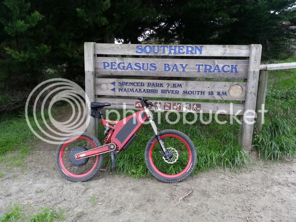

I Did a 40Km ride today at Burwood forest park A really nice track about 20 minutes from my home. Its right beside the beach at Pegasus bay. Unfortunately my son and wife were busy so no one to ride with and I forgot my video camera!
I will try and get some video there with my son soon!
I think i forgot to say this before but I love riding my Bomber! I am so pleased I sold my motorbikes and bought the 2 Stealth's! some pics from the ride below.
