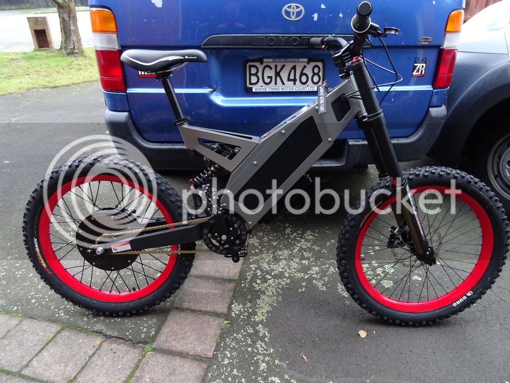

Well i have finally had a ride on the new Fighter all i can say is awesome!!!!
The ride is soooo nice with the new front forks this is such a big improvement well done Stealth
Hugh
Looks good. Is that seat what comes on Stealth's now? Looks more comfy than the ass hatchet that came on my Bomber.

Hi TV
No I don't like the standard seat either I put a better seat on it from the start!
Hugh
