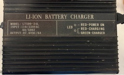

Here’s the charger I got with my bomber. Isn’t the 87.6V output used for 24s battery packs?

LFP vendors used to spec over 3.6V per cell
May not be "dangerous" but certainly not conducive to optimizing lifespan.
3.45Vpc is much better, still gets to 100% SoC if you let CV hold until amps drop.

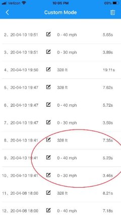

Being bored at home due to the pandemic I had idea of taking the Dragy off of my car and putting it on the bike for some performance testing.
I figured 100m (328 feet) is a decent equivalent to 1/8 or 1/4 mile testing for automobiles, so I customized my Dragy runs to capture: 0-30mph, 0-40mph and 100m times. Just for reference I am 205lbs and testing a stock Bomber will do high 4 to low 5 second 0-30 mph (depending on SOC and rider weight). The best time on the bike pictured below was achieved with with my highest controller setting tried that day of 150 battery amps and 300 phase amps, with flux weakening and boost mode turned off.Bomber.jpg

Are they? I have no frame of reference because nobody seems to use such short distances for a performance metric :lol:
TV phase amps are like the cocaine of Ebikes. They are addictive and will surely be the reason for my packs early demise! :twisted:
Some good reading in this thread: https://endless-sphere.com/forums/viewtopic.php?t=82510

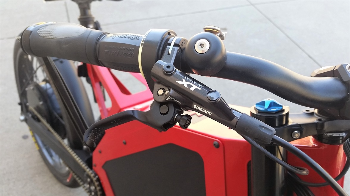

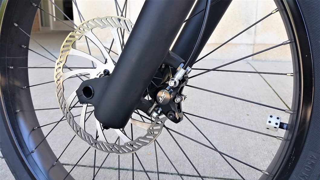

The front was easy to install, but I'll have to cut the line to install the rear, which I haven't done yet.
