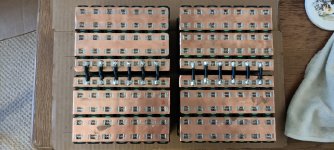

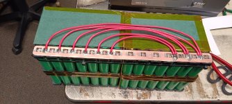

Glad to hear it TV, Got any pics of the batter build in progress? That's the one area I lack skillz?I just finished building my first battery pack for my Bomber. I tried to find an adequate replacement for over a year for my third worn out battery, but no one wanted to build one like I wanted, and Stealth aftermarket is nonexistent. Now after building it I can understand why, it's a tough one to make, but it's worth the trouble. Now I don't have to rely on anyone for a new battery. Since installing the 80 amp controller, and QS motor the year before last, this is the first time my bike has been able to really take full advantage of it. After all these years my bike has never run this good.View attachment 359698
I was able to use plastic cell holders, which cut down on a lot of extra work.Glad to hear it TV, Got any pics of the batter build in progress? That's the one area I lack skillz?
