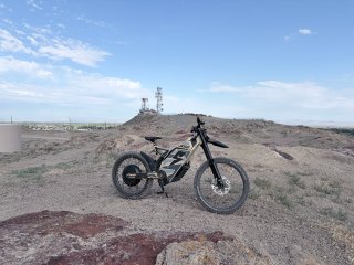

Wednesday's ride. GPS Confirmed top speed of 61.35MPH, or about 99KPH.
that must felt fast and so close to 100.
