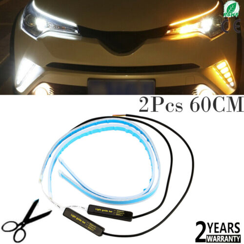

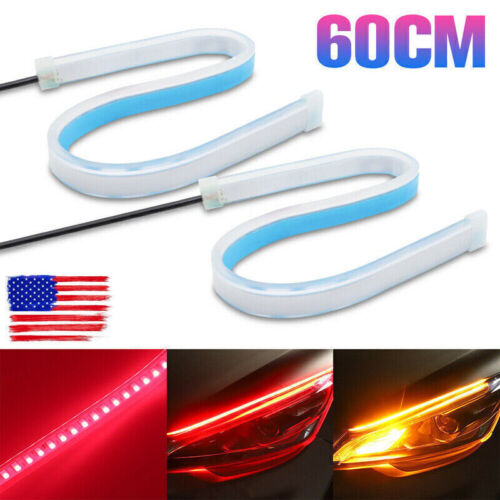

If you really want to grab attention, you might look into these, which can just stick on, but I glued them on with clear GE Silicone I (using zipties to secure them until the silicone cured). :
They're DRLs (white front, red rear) with sequential amber turn signals, no flasher needed. Some of the red ones also have a brake flash function.
For a typical bike frame you could install the white ones on the fork stanchions, and the red ones on the seat stays or rear rack supports, etc.
On SB Cruiser the white ones are on my handlebar-mounted mirrors and "brush guards" (which I really use just to keep my hands a little protected from whatever weather is happening and for holding these lights). The red ones are up high on my cargo deck's upper rail, so visible even to SUV drivers, and like the white ones they wrap partly around the side so they signal at least 90 degrees per corner (more, really).
This post
shows the front ones in just the brushguard and handlebar position I used orignally, but nowadays they instead go from the mirror down to the guards, making a kind of > < shape from the front. There apparently aren't any pics of the red ones on the rear cargo rail, but they look similar to the other red strip lights that are in various images, just a lot brighter and more visible in the daytime as well.

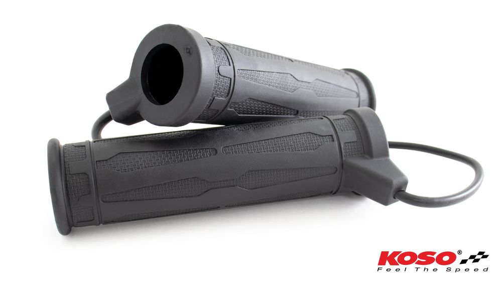

Wow, you've put a lot of neat stuff into your ebike! What kind of heating element did you use for the grip heater? Nichrome wire or something else? How much power does it draw at 0 degree C?
I used Koso heated grips (meant for atv / snowmobile). I of course get rid of that control box, that came along with it. And do controlling using arduino. It takes maximum about 40W power, if i use highest settings ( i made 5 different modes)
I wanted to arduino control those grips, so i can add everything nicely to my bike. I didn't want to add another led etc, so i decided to show what heater level is used using my main / power button led. It already blink red, when alarm is used. Glow green when everything is ok and can ride. During ride if it start to flash also blue (so solid green, and blue flash, and solid green... again and again) it means that battery is cold and heater is active. It goes solid green when it is warm again. If battery goes too cold, then red flashes, and bike disable regen braking. Because then battery is near 0c and i want to prevent that there is no regen (charging) at battery then.
That led also show when blinkers are active (blink green, same time when blinkers etc). And i have 5 level of heaters. Lowest, is blue, 2 level is warmer blue. 3 level is green, 4 level is yellow, and strongest mode is red (so colors go cool to warm). When i press button it start to roll those levels, and when it is level that i want, i just let go of button. After that led goes off and back to green, that notify me that selected mode is accepted. And when i scroll after mode 5 there is led off section, if i release button there, then grips goes off. It saves last used settings, so if i used level 5 last time before i shutdown my bike, then i just need to press button briefly and it loads last used level
There is short video about it:
Those are grips that i used:

Is the 60 cm (24") length 12" each for each? Are they bright enough for daylight under bright sun? If so I may get these under the rear rack. Can they be bent to be 6" long?
I attached some pics and video links that I just took to help see what they look like. You can see some of how they bend in how they're mounted on the trike, and the not yet used ones laying on the cargo deck with the ruler next to them. IIRC you can cut them at certain points if needed, and move the endcap to the cut point, but I wanted more light so did not cut any of them. In the ruler pic you can see two of them have boxes on them; these are the front white / amber lights, the rear ones have all their electronics on the strips (there's some pics of that part in another post near the last linked SB Cruiser thread post above, from the rear one I had that sort of died (powers on but "sticks" before it finishes "booting up". ) )
They are designed to go on cars in the gap between hood and lights, or trunk and lights, and be seen edge-on thru the silicone strip, hiding the LEDs and making a smoother more even light. I wanted more lighting surface area and brighter, so I use them face-on where you actually see the LEDs. I removed all the gunk and adhesive on them from the factory rather than using that, so it might be good, might not, but I knew GE Silicone I would work. :)

Thanks for the info on the LED strips. Ordered one from Ebay, should get here Wednesday.

The LED turn signal strips arrived early. They are pretty bright! It's too long the way it is. I think the LED's are all in parallel and I should be able to cut it to any length. I wrote the seller about cutting. Waiting to hear back.
THe LEDs are in sections that are parallelled, probably 12v at a time (usually 3 LED sections).
On mine I think the box showed where to cut them, then glue the silicone cap on the new cut end of the strip, but I don't have the boxes anymore to check.
For the strips I have as just markers on teh trike, with no blinkers in them, they are wired this way, and if cut in the middle of a section the rest of the strip still works but the other 1 or 2 LEDs in taht cut section won't light because they have no series connection to power. I didn't cut my blinker strips because I wanted as much light as I could get. :)
Seller has not responded yet. I took the adhesive tape off to have a better look. Is that a resistor every 3 LED sets?
If I want 21 sets of LED's to light up, do I cut at the blue arrow? Edit: No instructions on the box where to cut.
