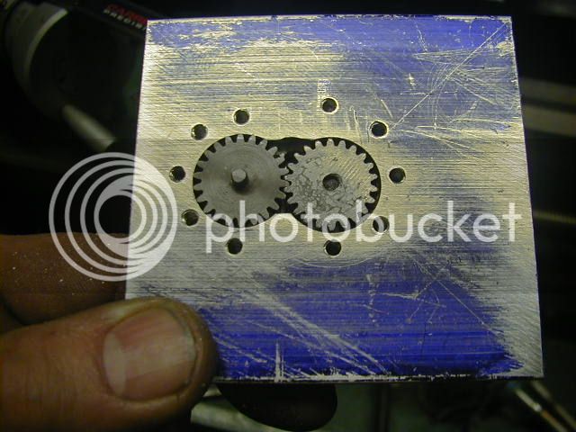

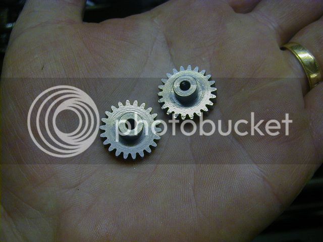

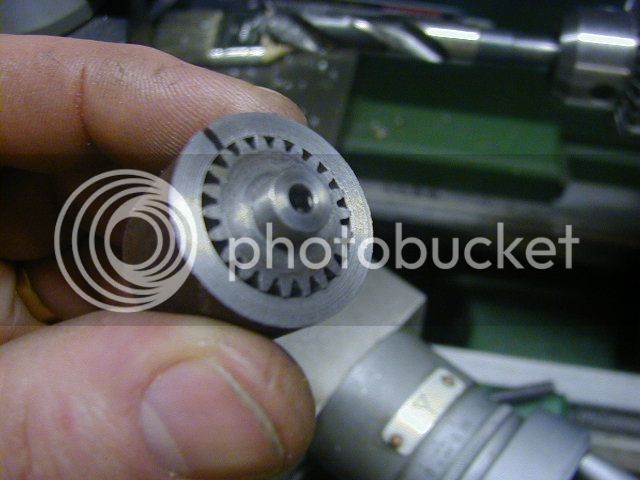

here are some teasers of the gear pump parts:
Nice pump!
