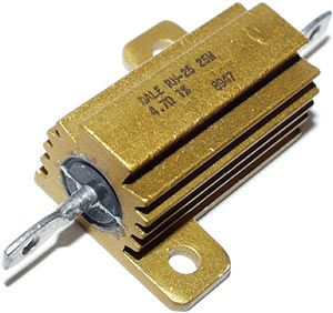

i was wondering if http://www.vishay.com/docs/30213/cp.pdf style resistor or
style could be used because it would be easier to attach a heat sink to them to get rid of the heat better?
correct me if i am wrong the other thing is maybe it is better to let the resistors get hot because heat cuts down on the efficiency causing more power to be wasted as heat otherwise it may take longer to bleed off the power to balance the cells.

I over-rated the shunt resistors quite a bit to help reduce maximum surface temperature. Ideally they should never exceed 100C on the surface, but they can withstand much more.
The shunt transistors get pretty toasty too, but same thing applies.
