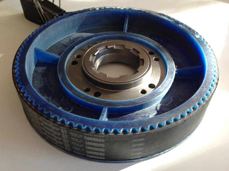

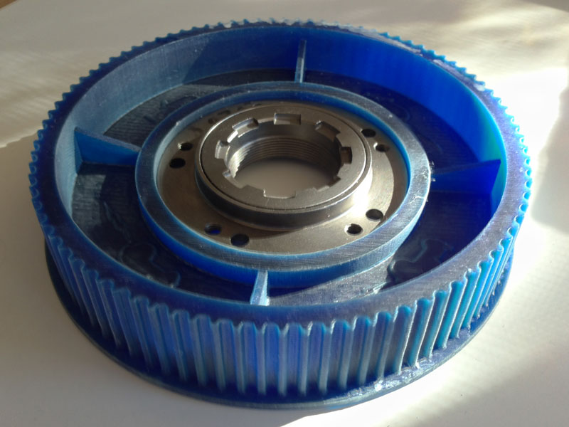

My 3D printing service bureau just called. The prototype for the 90 tooth GT2 pulley is finished and shipping tonight! :D I will check all of the dimensions and then pull a casting mold. I should be making production pulleys by Thursday or Friday. Stay tuned!
Times like this make me wish I had a GNG 1.1. :x
The 25mm GT2 belt fits perfectly and the ACS Crossfire freewheel fits perfectly. It looks like we have a light bulb. :idea:
The only thing that stands in the way of being able to bolt this pulley right up to any GNG Gen 1.0, 1.1, or 60v chain drive is the thread on the steel 1.375" freewheel thread to 12mm bore adapter that comes with the GNG. The one I have will thread onto cheap 4 bolt Chinese freewheels but not a quality 5 bolt like ACS or White Ind. It's been suggested than mine is a fluke because of GNG's 'quality control' and that may be. I am going to make both 3.07" flange to 12mm bore adapters for people who do not want a freewheel in this location, and a replacement 1.375" to 12mm bore adapter that fits quality freewheels. At the point where I am making my own stand alone mid drive kits I will not have access to the freewheel adapter that comes with the GNG anyway.
I'm making a mold of this prototype pulley today and will be casting production pulleys tomorrow. Barring the unforeseeable I should be shipping production pulleys by Thursday. :D FINALLY! :D

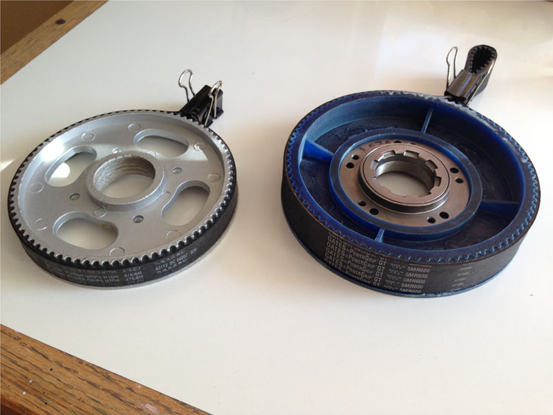

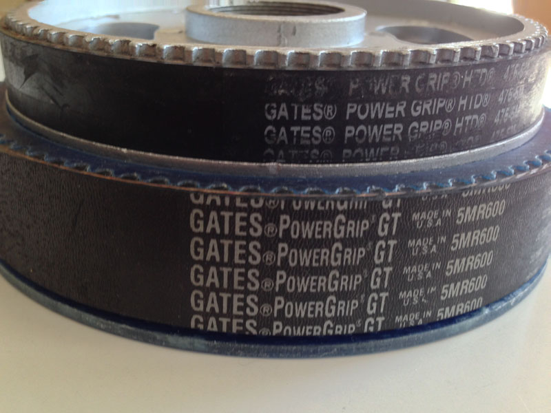

Some visual comparisons between the stock GNG pulley and my new GT2 pulley.
The diameter of the 90 tooth is not that much greater than the 80. It will fit any version of GNG fitted with adjustable sheets.
This is the main difference. 66% more width on a belt pattern with 2x the grip of the HTD that comes with the GNG.
I want to point out that the freewheel should last a very long time in this location. The biggest reason for moving it to the primary (belt side) instead of the secondary (chain side), was to achieve much more reduction while using reasonably-sized pulleys that will still fit.
However, The stock GNG drive 12T freewheel is not only an item from the "affordable" parts catalog (not strong), it is also located on the lower-RPM / higher torque side. In LightningRods configuration, the freewheel is moved to the higher-RPM / lower torque side.
The Bikemotive flanged freewheel is larger than the stock 12T too, so each pawl and bearing ball is less loaded than what they would be on a smaller freewheel. The quality of the steel in the Bikemotive bearings and pawls is also much higher quality.
