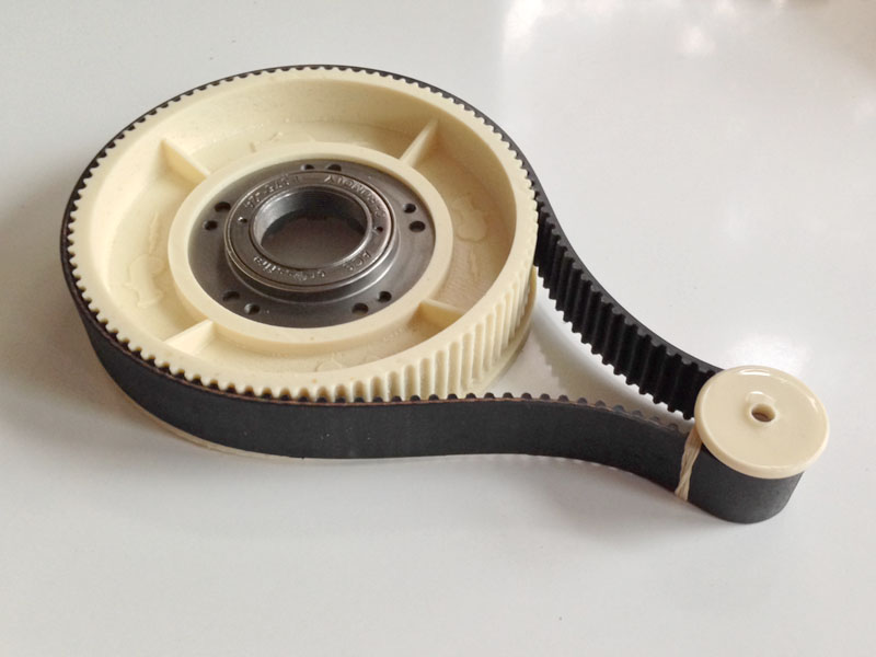

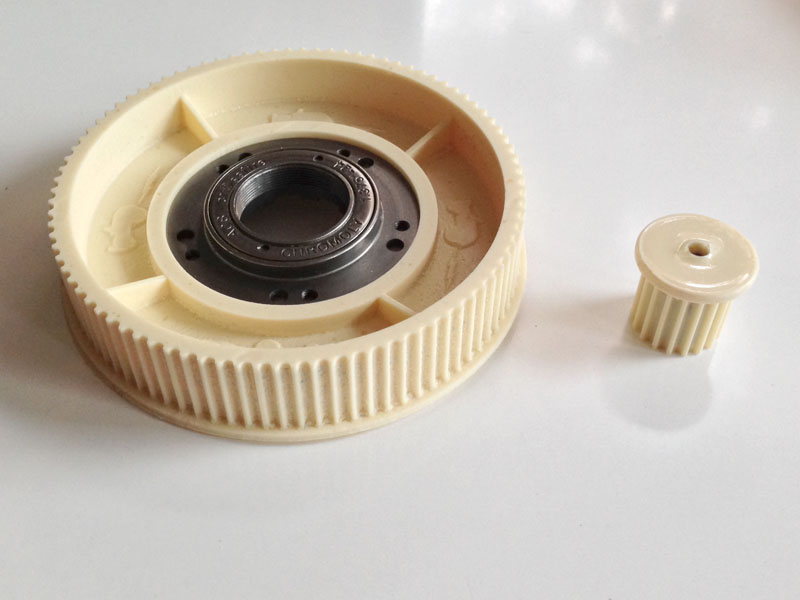

I completed my production molds and poured my first 25mm wide GT2 pulley set. My hours and hours of obsessing over the CAD model paid off. Everything fits and lines up perfectly. There are about 1,000 ways to do this wrong and I think I found 999 of them.
I'm excited to get these on my bike and see how they perform!
Looking great - I'll be up for a set, especially if they come with a belt or two...
The light at the of the tunnel . Looks like all your hard work is coming together, nice!!! I received your 18t driver, fits like a glove over the 14t driver. No test run yet, but this should be a big improvement THANK YOU. :D
Thanks guys! I feel like a proud new father. I'm excited, and nervous, to see how my 'baby' performs out in the real world.
I ordered some black pigment that I can use to tint the plastic during casting. The plastic company says in their literature that paint is good protection from UV so I may follow up the embedded pigment with a coat of satin black on everything but the teeth.
If the Gates distributor is open today I'll be heading over his way to see how much the 25mm x 535mm GT2 belt we need costs and what I have to do to get them in stock. I'll ship as many belts as people need. I personally would not order more than two because they should have a long service life. If my pulley design allows these belts to live up to the claims by Gates we are all going to be very happy. The road will tell the story.

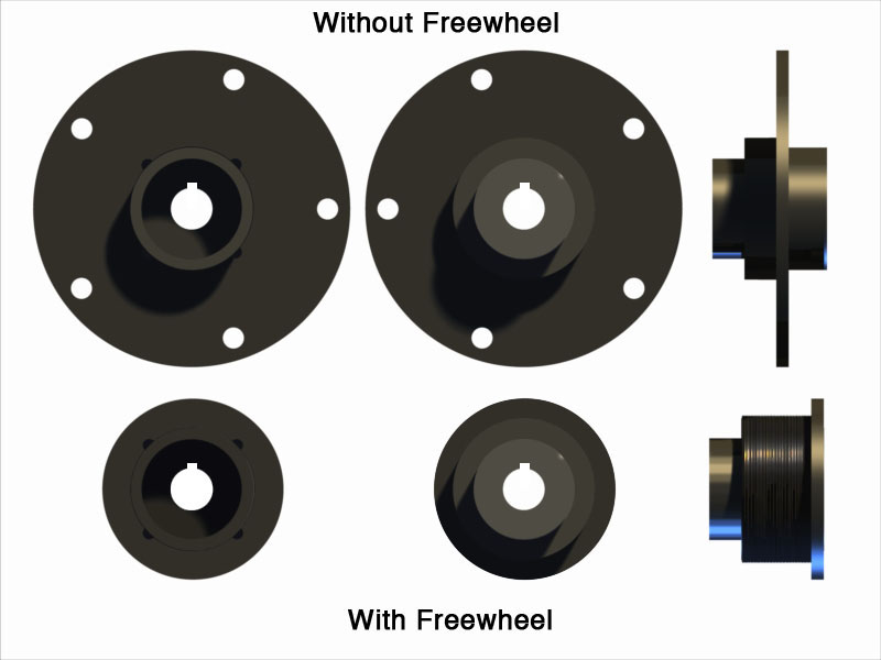

The final piece to this puzzle is fitting the large pulley to the jackshaft. The GNG kit uses a 1.375" freewheel thread to 12 mm keyed shaft adapter made of steel. On my particular kit this adapter will thread into Chinese freewheels but not my ACS. My opinion is that this adapter has a metric thread pitch, others feel that this is just GNG 'quality control' at work. Because I will need them for my own kits regardless I'm having new adapters machined that will have the same 24 tpi thread that the ACS and W-I have. You will have your choice of adapters with or without freewheel.

Here are renderings of the two freewheel adapter options I'm going to offer:
The No Freewheel version bolts the driven pulley directly to the 12mm jackshaft. Another benefit of these adapters for you chain drive lovers is that both of them are compatible with my #219 adapter plate meant for the BB freewheel. So you'll be able to swap in a good quality 219 kart chain in any tooth count from 64 teeth to 93 teeth. Get a good Japanese 219 chain and you might have something. I'd still replace that 11 tooth driver Jon used.
This belt drive should be way over-engineered for this motor. 20 horsepower racing karts use belts like this as do Matt Schumacher's high end Astro Flight drives putting out 10kw. I think a properly designed 15mm GT2 drive would have been enough for the small GNG motor. After all of the grief everyone has gone through with GNG's horribly designed belt drive I wanted to make sure.

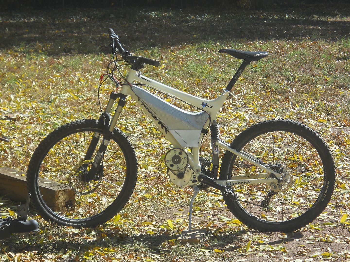

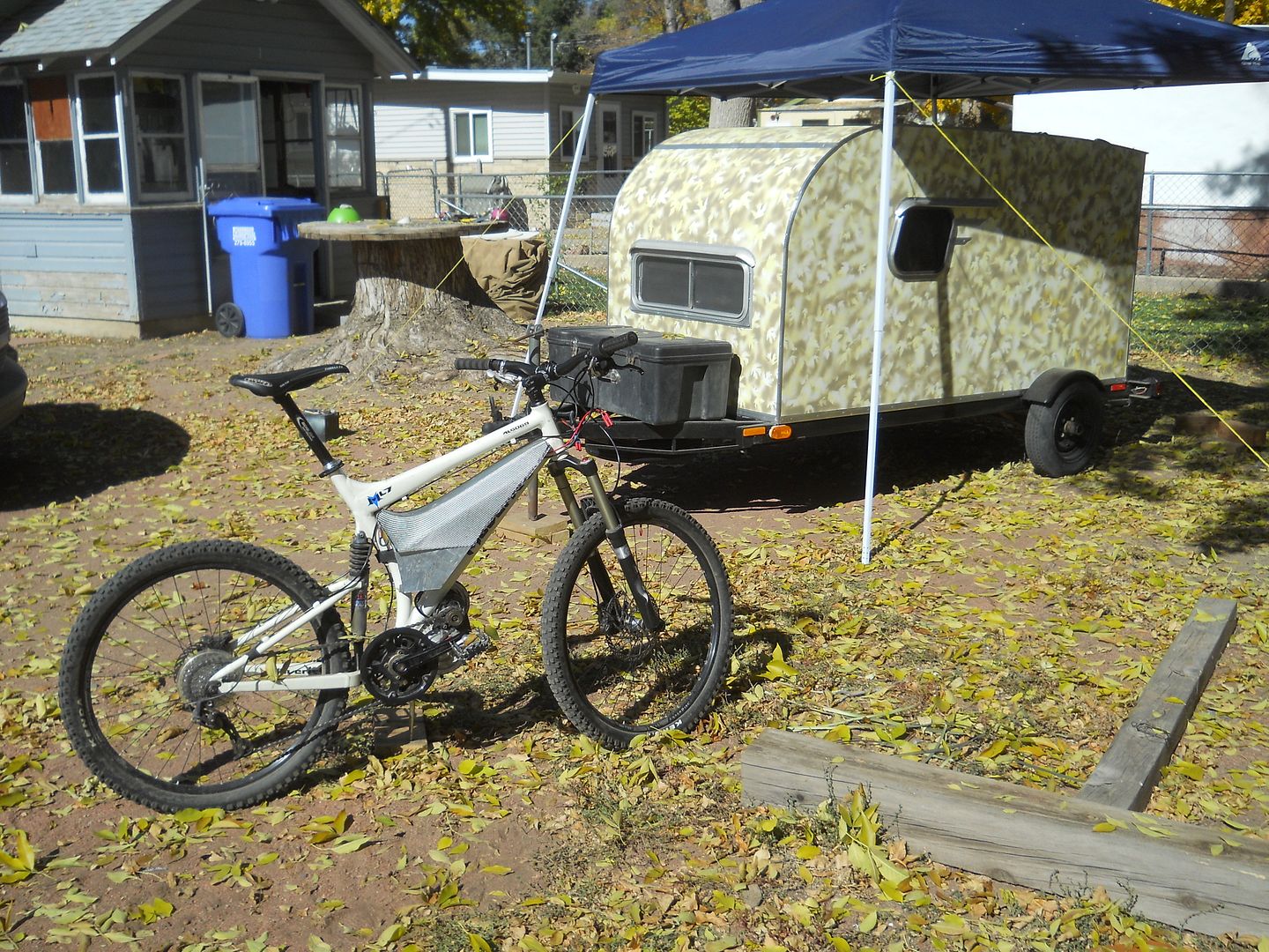

I've been building a camper trailer ( Including the frame) for the past two weeks and needed some relief from burnout on that project, so , this morning I pulled out my Maverick ML7 , its the only full suspension bike I have , and started building it up , got it to the running stage and had a good test ride , mocked up the battery box ( jury is still out on the looks of it) and am now pondering how to secure the motor, this is a floating BB bike and there is a spud on the BB shell which I can use to secure a torque arm.
Anyone else build a GNG using a floating BB frame ? I looked through the builds and didnt see any , so, I do have an Idea but always like to hear how others handle things.
Here is where I'm at after about 3 hours >>
