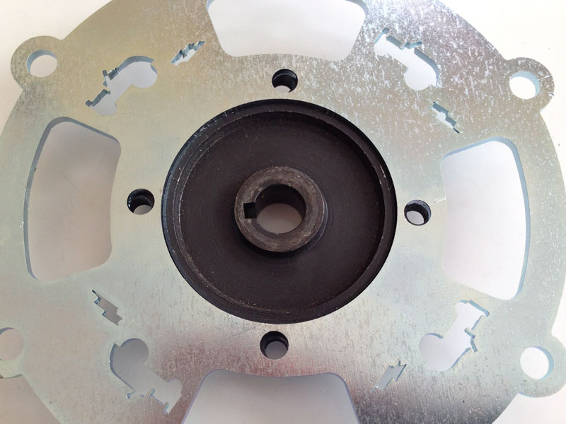

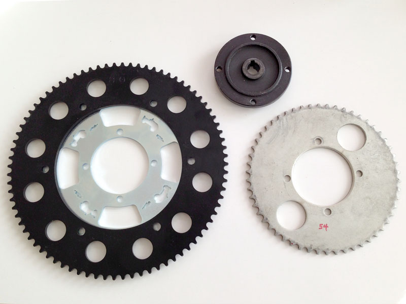

I've been playing with Wishes' 60v chain drive parts some more today. The adapter hub fits my #219 adapter plate and the 25mm wide GT pulley perfectly:
In addition to being able to bolt up far better quality sprockets and chain, now there is a choice of 64 tooth to 93 tooth driven sprockets. Basically, you can bolt on as much reduction as you physically have room for. A 80 tooth black sprocket is shown next to the 54 tooth GNG sprocket.

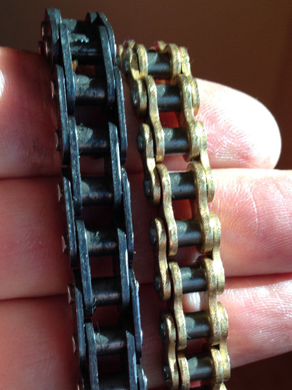

I also took a close look at the GNG primary chain, which is a cheap #219, compared to quality Japanese D.I.D. kart chain. The chain I use is their 219HTZ-SDH gold chain which has thicker side plates and heavy duty hardened roller pins. Both the inner and outer plates are about 20% thicker than the GNG chain. What doesn't show is the quality of the metal. The best Japanese and German 219 chains have very good metal in them.
All that's left are driver solutions. The skinny little 'pizza cutter' 11 tooth driver is the worst part of the 60v chain drive. Just like the 14 tooth driver pulley on the belt drive, GNG cheaped out right where it really hurt.

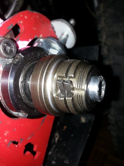

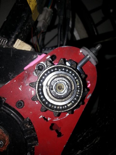

I rebuilt it, might work for another hour. The pawls were stuck down.
Any idea how to remove the freewheel? I hammered on it for a while but it didn't budge. It seems to be the standard slotted keyway, but this one is stuck on there really good. I guess I need something like a bearing puller?
Is that a hex nut holding the freewheel on the jackshaft? Maybe if you take that out then you'll be able to pry off the freewheel with two flat tip screw drivers like the 1.0 freewheel.
