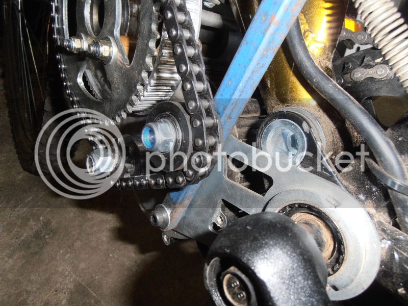

Just thought I'd let you know , dad (Roger). Had a few drama's with the belt drive , so has now changed it for a chain drive. Much better , more power , a little more noise . And most of all reliable .
Dad is riding it every day , it has totally given him a new out look on life. Riding all over the fire trails where we used to run training for my boxing for 15 years , going out of town to mates places , getting the bread..ha ha.
Best $400 ever spent.
Tim

full-throttle said:
How did you remove the original pulley?
Hi.
The main motor pulley is part of the motor shaft. So he basically took off the washer in the end of it , then ground it down a little , machined up a sleeve that went over the top of it , and put a sheer pin through it...( you can just see it in pic 2) fits very well. Then threaded the end of it , to hold the new chain cog on.
One note is , between the end of the thread and the hollow in the inside ot the sleeve , he left about 4mm , it take the load , and the side walls of the sleeve are 3mm thick.
Hope that's clear as mud.. :D
Tim
Timbuck, you may want to change the chainline so it wraps around the sprocket more. Maybe putting the idler on the other side of the chain would do it.
