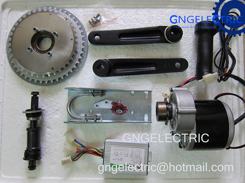

GNG, 1000W 48V BB-drive, $400
i'm in the middle of putting one of these on Hummer(montague paratrooper) but have lost the installation manual. :shock: i emailed gng today for a copy, so we'll see how long that takes. but anyway, the motor fits on Really nice! the bike will still fold nicely and i've got an old set of tora solo air to put on it. i read the posts (or is that thread) and am encouraged that this is gonna be good. i weigh 215 and live on a pretty big hill above town. i've already found out that a bmc v2 with a 48v 10a/h lifepo won't even get me up the easy way, with pedaling! so i decided the solution is a mid-drive. for roughly $450 this seems like a good way to start. at some point i will probably want a better controller, but am looking forward to just getting it running with what i have. will post pic's after it's done.
I run mine with a 36v controller. I'm using a cheapo 9FET 22amp one from BMSBattery, but I soldered the shunt to get 25 amps. It'll do about 25mph on the flat and is too fierce in the bottom gears, but will pull away OK in top gear if you're lazy. It's difficult to compare efficiency because, unlike a hub motor, full power is available all the time and at whatever speed. It's quite good fun when you're already going down a steep hill at 30mph, to open the throttle and still get an additional 1000w accelerating you up to 40mph, which wouldn't happen with a hub-motor. If you're sensible with the throttle (which isn't easy) it uses about the same power as my 500w rear Bafang BPM motor.
Cadence is about right, I'd say. No-loadis about 125, but it's less under load
You can buy the kit with a 36v 22amp controller as an option.
I also tried it at 15amps , but then it could only climb steep hills slowly in first gear and it felt relatively gutless.

Here is a pic of the first reduction. The bigger wheel got a pin key. The small pulley seem to be part of the motorshaft, as timbuck already stated.
Im going for a 13/72 chain-drive. #25 chain. From this place probably:
http://www.electricscooterparts.com/sprockets25chain.html
That pulley on the motor is in front of the bearing. Must be just press fitted.
Something like this might take it off.
I've ordered several small components (wiring connectors, brushed controller) from those guys, and stateside they ship instantly. Usually I get packages in 2 days - they're west coast N. California - so, it would be international ship to Sweden.
The small pulley doesn't seem to have a simple solution (yet) - someone's gonna figure this out soon, is my predict.

My kit came in today. Only took 5 days to arrive.
Here's a video of some of the quirks I encountered installing the thing. I have run out of sunlight here so no riding yet, but I hope to finish it tomorrow so I can have some actual performance videos for you guys.
[youtube]yyX61_-HlVw[/youtube]
Had issues with that chain idler as well. Swapped for a big automotive spring from the collection. Just finished my chain guide (photos coming) and new cassette, shifter and derailleur arrived yesterday, work to do. Are you going to run BOTH drive systems together? THAT would be fun to try and see.
I might try running both just to see what happens, but I presume I will end up running one or the other in the long run.
I haven't put my regular tires on yet; I was too eager to give it a try and just went for it with my hub still on (not powered). I encountered a few problems:
-when the motor gets to around the 75% of top speed mark the motor does a weird skipping thing. Belt and chain aren't skipping it's the motor or controller doing something. (see video)
-when run at 1000 watts it lingers at the 75% zone and makes for a rough ride, but when upped to 1500 watts it pushes right past the rough part.
-when run on the 11 tooth gear it skips teeth at 1500 watts. When run on the 13 tooth gear I had no problems. No skips from the belt, or the other chain.
-slow top speed on 1000 watts, but decent top speed at 1500 watts. I need to hook up my speedometer to know the exact speed, but I suspect low 30s.
-The motor at wot is too fast for your legs to keep up and help with the peddling. (12s lipo 1500 watts)
It's not bad noise wise. It's quieter than my 9c when it makes the "9c hum", but louder than when the 9c is in regular operation. It is about the noise level of a regular sewing machine.
When first driven the cog that drives the belt made a mild grinding sound, and a few metal flakes came off. After about 300 meters or so it ground whatever was giving it a problem off and started running quietly again.
