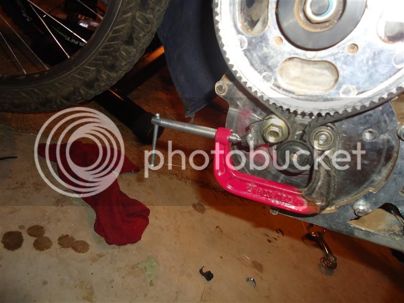

I tried the 150mm option and my belt broke after a few rides. In all fairness the belt was damaged a bit from stretching the sucker on.
I currently have a pinch style setup where the 175mm belt gets pinch tightened between two rollerblade bearings. This didn't work for very long because I removed the lower rail to allow room to weld on the pinch tensioner and the belt slipped up onto the edge of the little gear and gobbled up the belt.
I will get another belt ordered, weld a belt guide on, and post some pics up if I get something working.

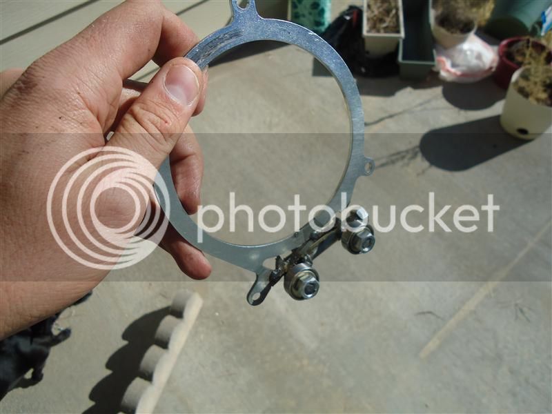

One good beltmod. option could be just moving the jackshaft forward. I did this when converting to chain.
The process of creating new sheets was fairly simple, it took maybe an hour with standard tools as cutter, drill and filing in aluminium. (these are weaker than standard GNG-sheets but it doesnt matter when combined with a torque-strut)
The sheets get the jackshaft 15mm further away from the motor pulley. Im thinkin about creating one more pair of sheets with 25mm extension. With these it could be possible to have a huge 8:1 first reduction, belt or chain. Then it would be fun to get a bigger 50tooth on the pedal driven side. Finally a bike with slow trailspeed and correct cadense 70kph+ with pedalassist. 8)
