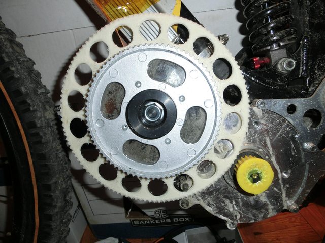

I'm working on a sprag bearing adaptor for these axles.

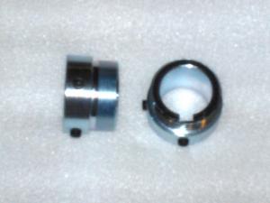

Staton-inc FW adapter bore with keyway and two set-screws, $14. (I wouldn't use the bolts in the pic, but at least the threaded holes are there already)
1.000
0.748___19mm
0.252 = sleeve adapter with 0.126-inch thick walls...very doable!

CSK bearing fitted with an steel adaptor sleeve that has a 48 spline bore and a square keyed OD.

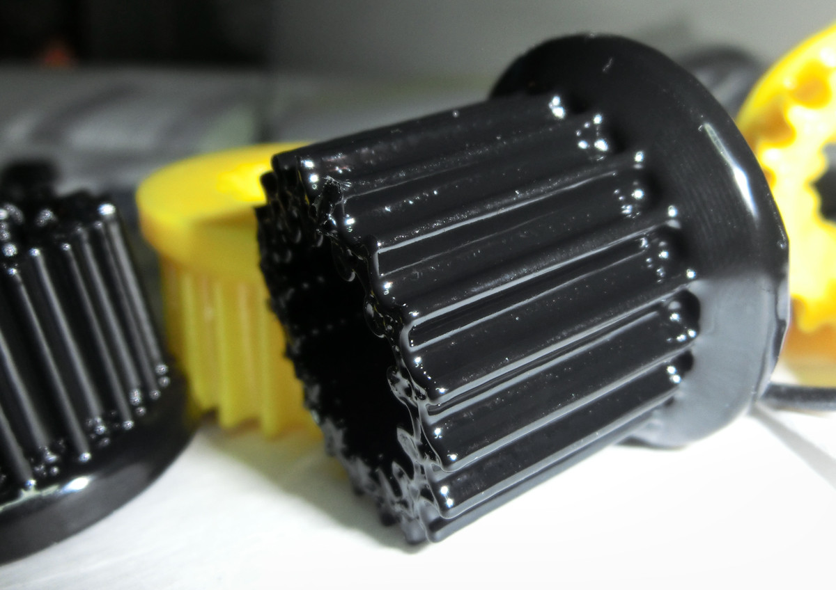

Oh hey, this acetone vapor polishing works great on the surface of the gears
After fudging with the parameters a bit, I got a 14 to 18t sleeve to print without any gap in the wall. This one will probably need a bit of filing to fit since I had to lie about the thickness of the print head a bit to get the g-code generator to squeeze plastic into the tight areas.
I'll send a few of these out to anyone that wants to try them. You will need the 95t or larger sprocket to use these sleeves, they are useless on their own since they change the gear reduction too much.
The offer is still there if you want to send me one I will cast a few in the resins that I have here and send them out to anyone who wants one to test for the cost of the postage.

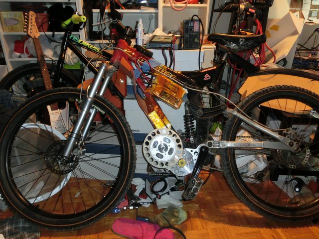

noticed a wobble on the crank gears today, did I bend my crank?
[youtube]X57ZEak1xFM[/youtube]
PM me your address and which gears you want, gwhy!
I'll send you some gears today LightingRods.
Completely normal. Even my Sick Bike Parts set up does that too. Just make sure it spins true under pedal and motor power.

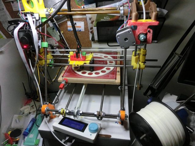

I got the larger 3d printer working, here it is printing an 80 to 119t adapter:
Still needs more tuning of the retraction to clean up the little plastic boogers and I gotta sort out why the extruder jams after half an hour. Then I can start to tweak the print speeds to hopefully reduce the 7.5 hour print job so I can finish printing one of these.
Man! That's a family size pizza! Does it come as close to the front wheel as it appears in this photo???
