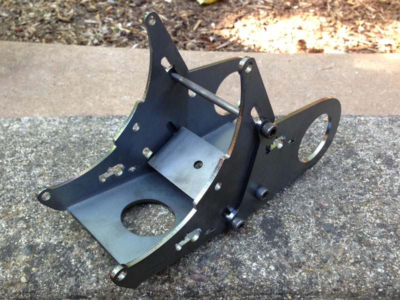

I just picked up the box above from my laser cutter. They have been swamped with huge orders and their lead time has gone from three days to three weeks. I even tried switching laser shops. The second shop I went to has still not produced anything after six weeks. I don't know how some people stay in business. Anyway, in the box above:
Adjustable sheets for 73mm BB. These are the strongest and best sheets I've designed to date. They come with a screw adjuster built in. Details and photos coming very soon. If you want a set PM me. These will sell out and it's three weeks plus to get more made.
Adjustable upper sheets for Gen 1.1 with enclosed jackshaft and mud guard. These sheets have a built in screw adjuster. The previous version without adjuster is still available.

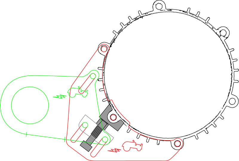

Adjustable sheets for 68mm BB with built in screw adjuster. The adjusters are inside of the BB sheets and adjust through the bottom. They not only make adjusting the tension far easier, they help hold the adjustment in hard use.

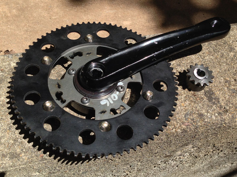

Adapter plate to convert the 48 tooth 1/2" bicycle chain secondary sprocket to #219 kart sprocket and chain. A 75 tooth 219 sprocket is the same diameter as the stock 48 tooth.
I tried cutting a 3/4" to 11mm adapter out of 1/2" plate steel in order to run a 12 tooth #219 driver on the secondary side. The laser loses it's clean cut path over that thickness so this may not work. I will use 3/4" rod stock and bore an 11mm hole if I can't use laser. I'll need to purchase a keyway broach to cut the inside keyway.
This last week I started casting slip on 18 tooth 22mm wide driver pulleys in high impact industrial resin. I'm getting good clean results now and need to make more molds so I can produce these in sufficient numbers. The resin has a fairly slow cure time. I lost over a month trying to cast these in zinc with a guy that wasn't up to the job. I haven't given up on metal versions but resin is what we have for now. I'm going to work out an end retaining bolt to make sure the pulley stays in place.
Next week I'm going to make the mold to cast a 120 tooth 22mm wide driven pulley for the primary side. My prototype is set up to take the five bolt ACS Crossfire freewheel. This is a far stronger freewheel than the wimpy little one that comes with the GNG and easy to source in the US and elsewhere. Moving the freewheel to the driven primary makes it possible to run the small 12 tooth 219 sprocket on the secondary side. Overall reduction with my primary and secondary sets is 44:1, better than twice the GNG reduction. Pedaling cadence drops from 150 @ 48v to around 70 @ 48v. Obviously for you over volters this will be a great setup.
I also bought a Gen 2 with the planetary primary and designed adjustable sheets for the BB. I'll take the drawings in to the laser shop on Monday and should have these sheets available in about three weeks.
