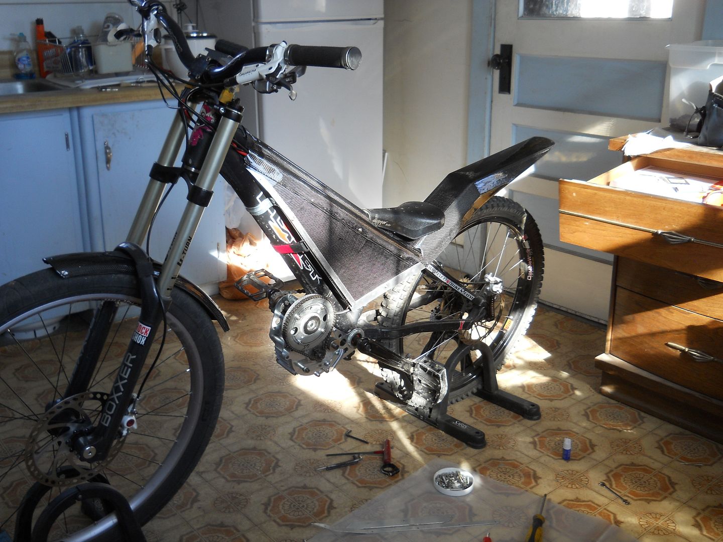

I recieved the carbon fiber cloth and started on the bodywork today , laying it up is the easy part, the finish work will take several days of hard work but should be worth it.
I also set up my 3 speed which works really well, I am using a 9 speed cassette at the moment to allow experimenting with different gear combos, right now its running 34t, 26t and 20t, using an Sram X-9 9 speed derailiur and X-9 3 speed shifter, it works out to shift 2 gears at once which seems to be a good gap between gears and shifts flawlessly, no issue with chain drop at all due to the double chain guide on the front chainrings, I think having the perfect chain length along with being a hardtail with short chainstays will eliminate any final drive issues.
also installed my Turnigy watt meter and Rockshox boxxer fork.

Carbon work is coming along, one more sanding and top coat should do it for these parts, still have a couple more parts to fabricate.
really nice looking finish to the guards you got there, was hoping you were going to put some more carbon on it, or you could have had some major issues with the thing splitting along the uni.
Wondering about the layup though, did you bag or clamp it at all? the finish on the guards looks to me like you didn't, but then the side panel looks like the fibres were pressed on the right there, so did you pressure the inside, then chuck on the final layer and let it open set to get the gloss finish? But the post before shows them all open drying, with no pressure at all?
Either way, they and the whole bike looks amazing, can't wait to see it all put together, going to look very clean!

Naw, these are all just hand layup, you know, kitchen table work, it is after all a dirt bike. I really didnt want to get involved in making plugs, then molds ect. and I gave up my vacume bagging stuff when I quit making kitesurf boards, the parts will hang in there though, I built all the bodywork for my Moto-trials bike the same way years ago and they still look good.
The layup is uni carbon , bi-directional 12oz fiberglass with some matt in certain areas and then the 4.5 oz carbon cloth using resin research epoxy. not exactly ultra light but strong enough to do the job.
Thanks for the comps!!
Parts loosely assembled , still need buffing, the pics dont do the carbon justice but you get the idea, I cant do final assembly untill I recieve the new controller since its a bit bigger and I may need to change some things to get it to fit.
Kinda thinking about doing the seat in carbon as well but that might be overkill?

Thats a good thought, I am pretty sure I can get 155 length trial cranks threaded for forward freewheel, I know I can get 165 but since the kits cranks are 170 I wouldnt be gaining much with either one, otherwise I'd have to make them. might help a bit with the cadence issue as well.
Without a doubt you need to change that seat. Carbon may well be the easiest way to make one, just carve a block of foam to the rough shape, chuck it on and fine tune the shape before you add the carbon, but I would not use the carbon finish. If you use a carbon seat I think it will turn it into a wanna be carbon gansta ride, instead of making it clean and minimal like carbon should. IMO, you need something the full width of the battery compartment, and some lines to compliment that top tube of the frame, tie it in with the battery covers and tail. Also, having a longer motorbike like seat on it could add a lot of support to the mud guard.
I think a moto style lightly padded and upholstered seat in either a red or yellow and some polished aluminium highlights along the battery covers would look absolutely mint, would it be possible to get an orthographic side view of the bike? I would like to have a tinker with the seat design, see if I can't tie the whole design down nicely. May even be possible to have a small compartment under the seat for lunch :p
As for pedals vs. pegs, I don't ride trials but imagine having that instant punch from the pedals could be nice, unless the motor is geared low enough/has enough power to do this. Also the legal aspects, it will look fairly moto already, and using pegs means you cannot try the push bike trick to get off, as it is certainly not electric assisting pedals, at least in australia...

trials bikes dont have seats per-se , the idea of my bike is to have a hybrid but still a working bicycle which has a very moto-trialsy flavor, the present seat is teloscopic and can be raised to a suitable pedaling height if needed.
I could have easily built a seat/fender unit like I did on my modified TY350 but thats not really what I'm after.
When I street legalized my Beta Techno I put a mini moto seat on it and I think it made it look like a enduro rather than a trials bike.
Before --
After-
Color scheme however is another matter, it already looks too carbon wannabe to me but I dont really know what to do about it, the side panels will have aluminum trim on two sides and there will be some red graphics along the upper edge of the triangle, I guess I'll just have to wait a see what it looks like when its done.
