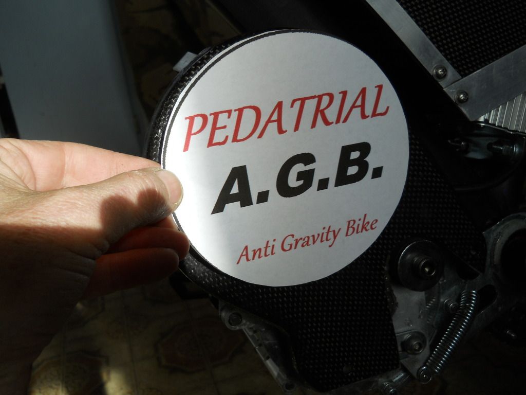

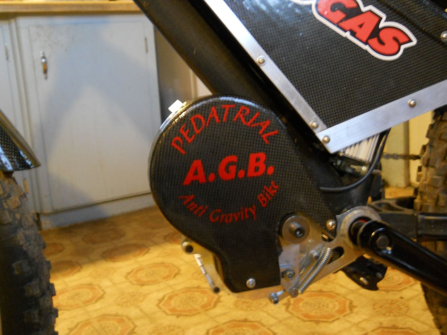

I also made the seat texured carbon, made a primary chainguard and installed the new tires, I have dubbed the bike " PEDATRIAL A.G.B.' (anti gravity bike) since we know downhill bikes as "Gravity bikes" it seems appropriate, also installed some graphics and tried to make my own custom graphics for the chainguard but failed bigtime. this is how that turned out.
Its supposed to look something like this, I am having a local shop make the graphics now.

The print shop came through with some nice work on the graphics.
I love your bike ,,, top job and its got me wanting to do a trials cycle again 8)

That sounds so great! Congratulations to a fantastic build! That chaincover is a piece of art. Some years ago i was building my own surfboards with similar technique and it was not an easy task at all.
