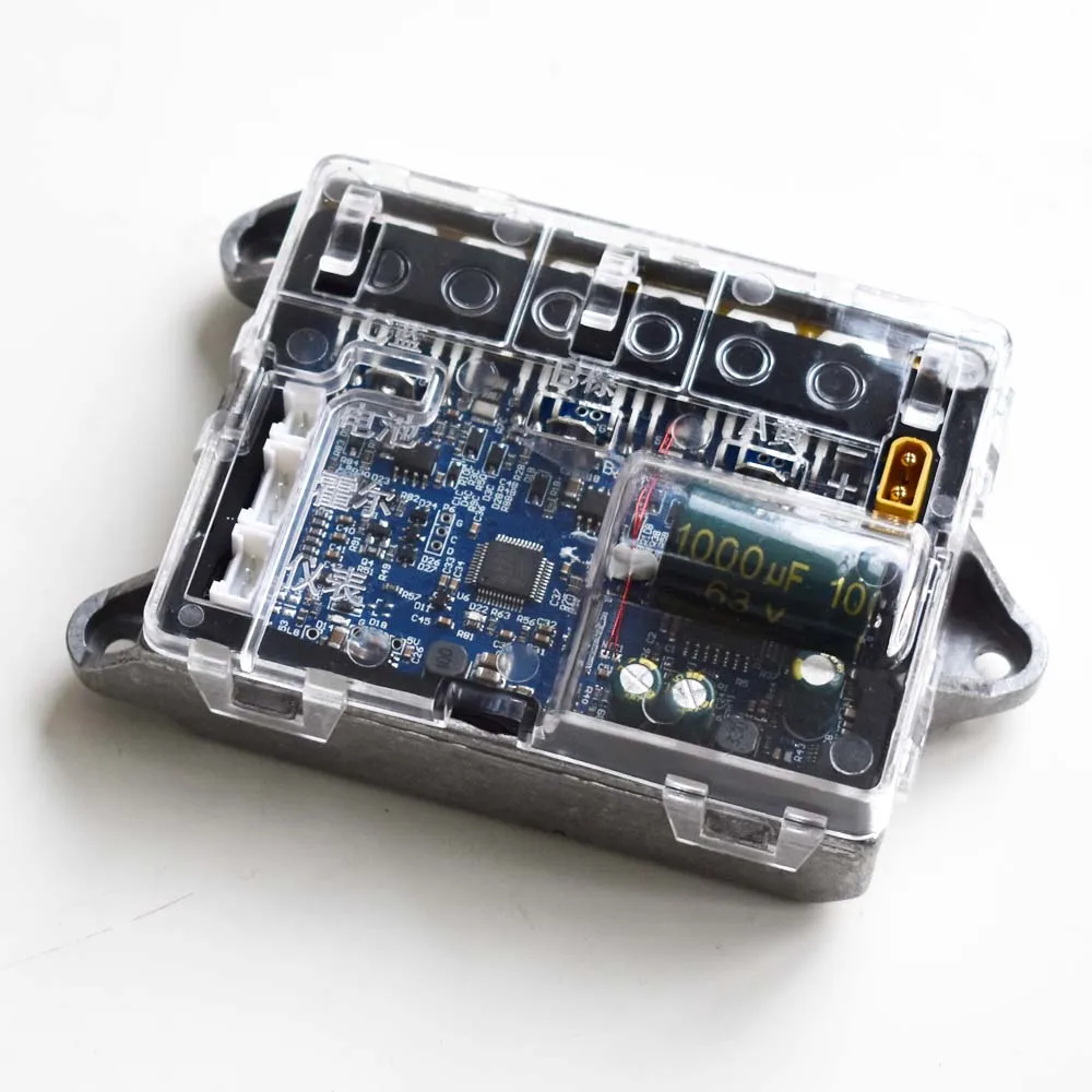

Hello everybody!
I am trying to run the m365 controller with the board version as in the photo with the analog throttle control via ESP 32. I plan to use from a voltage of 48 volts. Edited as I could config.h. Compiled into STM32CubeIDE 1.7.0. I flashed through the STM32 ST-LINK Utility using the ST LINK V2 programmer. Connected the CH431 adapter to UART3. And then I stopped. In the terminal, I receive the following messages like:
001875 22:39:27.944 20 30 0D 0A 30 2C 20 30 2C 20 30 2C 20 30 2C 20 || 0..0, 0, 0, 0,
001876 22:39:27.990 30 2C 20 30 2C 20 32 37 35 38 2C 20 32 30 32 30 || 0, 0, 2758, 2020
001877 22:39:27.990 2C 20 32 30 34 35 2C 20 32 30 33 34 2C 20 32 30 || , 2045, 2034, 20
001878 22:39:27.996 31 36 2C 20 32 30 34 34 2C 20 54 3A 20 30 2C 20 || 16, 2044, T: 0,
001879 22:39:27.996 51 3A 20 30 2C 20 44 3A 20 30 2C 20 30 2C 20 30 || Q: 0, D: 0, 0, 0
001880 22:39:28.002 2C 20 53 3A 20 31 39 34 33 38 2C 20 31 37 37 2C || , S: 19438, 177,
001881 22:39:28.002 20 56 3A 20 33 38 30 35 2C 20 43 3A 20 30 0D 0A || V: 3805, C: 0..
001882 22:39:28.052 30 2C 20 30 2C 20 30 2C 20 30 2C 20 30 2C 20 30 || 0, 0, 0, 0, 0, 0
How should I send the command 00 00 00 06 01 00 00 00 00 00 00 00 to the auto - detection of hall sensors ?
The config.h file is attached. And also, where should the power button contact be connected?
It turns on the controller both when connected to the ground and when connected to 5V.
You can send the command by any terminal program that allows to send hex data. E.g. HTerm

Am i sending command correctly in the terminal ? Are there any other conditions for starting the autodetect process ?
Ah, we have activated the checksum verification now, so you have to send the correct checksum in the last byte of the command. See here:
https://github.com/Koxx3/SmartESC_STM32_v3/blob/01552b90df5a8644e4f39e972dbc0c106f38abb8/Core/Src/display_ebics.c#L136
We have to update the readme!
Please ask in the Telegram group, see the link in my last post!
