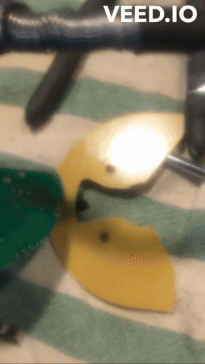

I have a motor that is making a grinding weird noise when driven. I got input from Endless sphere that this could be because of some non working hall sensors inside. But it is still a mystery what the problem might be.
I do have a controller that works without hall sensors as well. But anyway I got input that it might be smart to open it up.
So here are two videos below of the motor’s insides. First one is a bit general and shows what I have found inside. Second one is a close up of the hall sensor/chip.
To me it looks like this motor do not even have hall sensors there(?). So if someone could explain how this could be the case please do. I thought all motors had them perhaps ?
I also watched Grin's video among others about turning the wheel backwards and seeing the lights blink from right to left. I did this just to make sure my hall sensors are bust before opening my motor.
I got no signal at all of which I guess is because I don’t have any hall sensors?
I have bought some ss41 halls if needed. Not sure if the best thing would be to solder on these there and make a new connection. Or if the grinding noise might come from some other problem inside the motor?
To me the gears and motor looks fine overall. But I am no expert at these insides of the motor.
The video is shakey, a photograph would be better. It looks like the hall sensors have been cut off. Did you buy this motor new or has it had a previous owner?
It had a previous owner. Yeah my camera in the phone is a bit bad.
Here is another one. Hopefully a bit easier to see what is going on. My phone needs changing I know it is bad. But hopefully this one is a bit clearer:
Hi Cyclomania,
It appears to me, that motor board can be set up to handle hall sensors, but at this time does not.
A good clue is the numbers of wires coming off the pcb. A sensored BLDC motor will have a total of at least 5 wires going to the controller’s hall sensor plug. You have 3, with the remaining 3 connection terminal points looking pristine.
What I think you might have is one hall sensor on the top side of the board that might be switching with influence from a magnet mounted on the hub section removed and not seen that passes over it for a speed signal. A nice feature for geared motors. This signal would be toggling on the white wire.
For a bit more insight on testing hall sensored BLDC motors with a multi-meter, see this thread…
Testing BLDC motor's Phase Wiring - Hall Sensors and Wiring. - Electricbike.com Ebike Forum
Now the question would be, would it be worth it to install them, adding the wiring and connections needed.
Since you have the hall sensors already, I would probably give it a try… but that’s your call. (No guarantees it will work)
Make sure they are switching as required before putting it all back together. Good tips on bench testing in the thread!
Your controller with self learning capability will be an asset.

I'm somewhat confused to be honest.
If the motor was running sensorless from the start, was it ever quiet to begin with?
The controllers that I've seen do sensorless sine wave are mostly VESC based.
No not really quiet no. But seems to be nothing wrong with the function except for the grinding noise, which is irritating when riding the bike I have to say.
