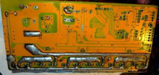

Controller Pron! Opened it up <gags from the smell> and immediately noticed this:
Note the smoke dust encrusting the red & black leads to the left.
But hold on Betsy. On the other side of the board we have some dark spooge. I've not gotten the results back from the chem lab, but I gotta wonder if this was WATER... in which case I deserve, well, how about several days off from work?
Best view I could get of the fets. All legs seemed to be in place, and no apparent burn marks, holes...
View from heaven, nothing special that I see.
I take that back about the fets. The last bugger on the left looks like he's been smoking in the bathroom. But maybe that was the cap splat.
South of the equator, note the water? mark bottom right...

i could cannibalize the end cap from the "burnt-fet ecrazyman" or from an old 75V steveo controller that i don't think i could ever attach the heat sink too.
photo attached as large file so hopefully has detail...
Looks like just that big 100V cap and some of the fets are blown. Take out the last 6 on the bad side, and do the check from the link on the thread that I posted eariler today. A guy posted how to test the fets, but you have to take them out. That should put you back in business if none of the Transistors and other tiny components are still good. Jump any traces that are burned away if there is any. :mrgreen:
It does look like water was the culprit, or toomany amps. How many amps are you running now?
yep, shorted fets. water droplets still in the case. on rain days, i used to wrap the controller once in tape, to cover the ends, but this one looked so nicely sealed that i only did the top. and i get a nasty spray in the rear... dang. that was quick!
thanks for that link, Tman. those are good tests. got 0 ohms when touching black and yellow. i don't have a fet repair in me for tonight. i spent two days searching for the solder braid awhile back and came up empty handed, so it's not happening tonight.
