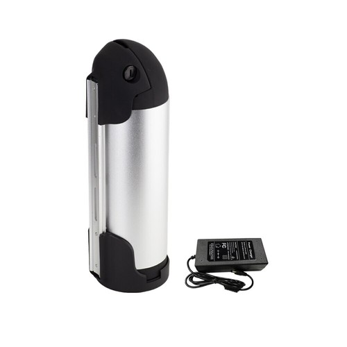

Hello everybody .
I have a Gtech bicycle . With a dead battery ( very common apparently) Would it be possible to switch the battery to a more ready available battery like this as a straight swap . Or is there a reason why not I'm not interested in adding a throttle or boosting the speed just want to use the bike before it gets scrapped . Thanks

If the battery has only two fat(ish) wires coming out of it, then all you need to know is what voltage it is, how much current your controller demands, and how much capacity you want. You should get one that comes with its own mounting rail, so there won't be a compatibility issue with the terminals on the battery pack.
That battery format is called "kettle" on the aftermarket.
Example:
The Gtech battery and holder has 4 pins . The image of battery in my post has 4 pins as well . Does that mean that the controller / sensor has feedback to the battery ?

Those are redundant power terminals that may or may not all be hooked up, but they're for power and not signal.
Just keep in mind that it is possible (probable) that your motor controller is inside the battery moutning bracket that's fixed to the bike. So whatever replacmeent battery you use may have to fit that bracket to make hte swap "easy".
Thanks amber wolf that was one of my concerns also . So if I strip down the plug and there is no PCB and just cables going into the frame then it is likely to just be a power source ?
Well after some deliberation and some information I found on facebook . The battery can be replaced and be plugged straight into the 2 outer terminals ( + - ) on the Gtech battery holder . The pedal assist works but you loose the option to run on lower power assist , this is what the 2 inner terminals are on the speed controller .
All i needed to complete the conversion was a motor extension cable , 6 pin extension cable and a new battery and holder , I stripped down the speed controller then put inside the saddlebag and ran the cables to the saddlebag .
