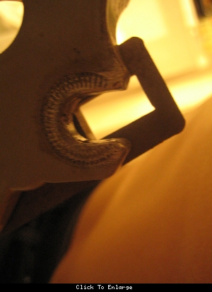

Anyway, I have most of the parts for my build now.. slowly making progress, but already running into some issues.
Built up the wheel myself, with some nice Sapim 12g spokes, laced to a beefy 700g 24" crystalyte rim with 30mm inner width. Had to bent the spokes a lot to get it laced, thinking they would straighten right up like a normal bicycle wheel.... but as you can see they're still pretty bendy. Anyone think that will be an issue?
Also swapped my narrow light XC front rim with a nice wider DT Swiss DH rim.
Here's two of my nice faaat mountain and road 24 x 3.0 rear tires, they just fit with no rubbing! :) tread clearance is huge, but the sidewall clearance is tiny.. I'll have to see how they ride first and if they rub from bike flex, but thinking I might want to file back the protruding welds a little bit, but not sure if that will compromise frame strength significantly. Anyone see a problem with doing that?
I also purchased one of those torque arms that bolts onto the rear brake adaptor mount, but it seems the angle is completely off from my drop-outs. Seller ignoring my email about it.. Thinking it might be worth it to file down the one side of the hole, to match my dropout.. and that way at least one side could have full contact, with almost none on the other side. Should still add some security that way, yes? I'll be using two Grin torque arms on top of this, but want further security. Thoughts?
Crap. As I should have suspected the slick 24 x 3.0 tire shown in the previous pic stretched a little wider just from holding air, and now slightly rubs on my seat stays.
Looks like I should just file the protruding welds down a little bit, anyone think this would weaken the frame much???
Nope, if you look at the pics I just posted you can see that the tread has tons of clearance, but it's the sidewall that's rubbing there.. bit of a bummer.
