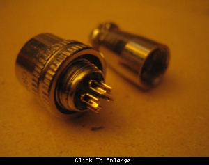

I will have to change out at least 3 of my connectors I think. This is an extra sensor connector, the motor is using this, so I will swap the controller's to the same. Now I'm not sure swapping connectors is too difficult.. so, basically just cut the wires behind the connector... strip them back, and then feed them into each of these tiny holes and solder? But which colour wire into which hole is the question... will I have to remove the heat shrink from the motor's to figure out how they should go?? The other connectors seem a little more straight forward.
I also have these bullet connectors which should replace the anderson phase connector on the controller. So basically just solder the wires into the little tunnel at the back of the gold connections? I haven't actually soldered anything in probably 10 years since I did it in school. Soldering seems simple enough, but any soldering or connector swapping tips at all appreciated. I thought there was a third connection I had to change but maybe not.
Motor connections

Okay, so... maybe too many things at once but first things first, I want to change the connectors.
The 5-pin "mini XLR" looks difficult to solder so I'll start with the XT150's for the phase connections. Now seems fairly straight forward, but I'm left wondering how I can tell how I'm matching the wires up properly with the connector already installed in the motor.
There's no colours or anything on the connector outers so... is there any way to tell without removing the shrinkwrap? Cause I'd rather not destroy it.

I have been reading around here a lot and I managed to find the pin number chart for the halls connector, but also learned my grinfineon controller auto-maps the halls! So I only need to get the ground and power pins correct and the rest will auto-sync!! Cool.
