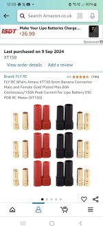

Ok. Can I use XT150 with 8 or 10AWG or what wire and bullets connectors would you recommend exactly?
Those aren't bullet connectors, they're Anderson knockoffs. 55A.
Note that phase current can be 2 to 3 times your battery current when the motor is under load (climbing, accelerating, etc.).
Sorry, wrong picture. I was thinking about 10AWG wire and XT150 connectors (picture)
