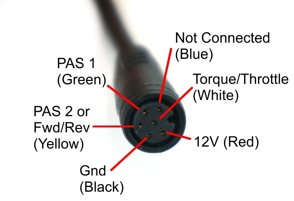

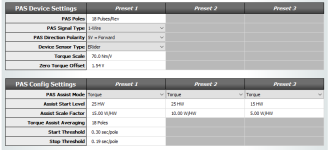

Shot in the dark perhaps, but I'm struggling to troubleshoot a lack of PAS power in my recently finished build.
Basically, regardless of whether the PAS configuration is set to "Basic Power" (i.e., cadence PAS) or "Torque" in Cycle Analyst, I'm only getting ~250W output max. Moreover, I even tried setting the "Start level" power as high as 1500W in Basic Power and the Scale Factor up to 10 Watts/Human Watt in Torque mode, but still the power delivery doesn't increase.
Is there some setting in CA that's limiting the power output? Could it alternatively be a setting in Phaserunner?? FWIW, power output via the throttle works fine.
RH212 rear hub
Erider T17 torque-sensing BB
Cycle Analyst (v 3.15)
Phaserunner v6
72V 15A battery
