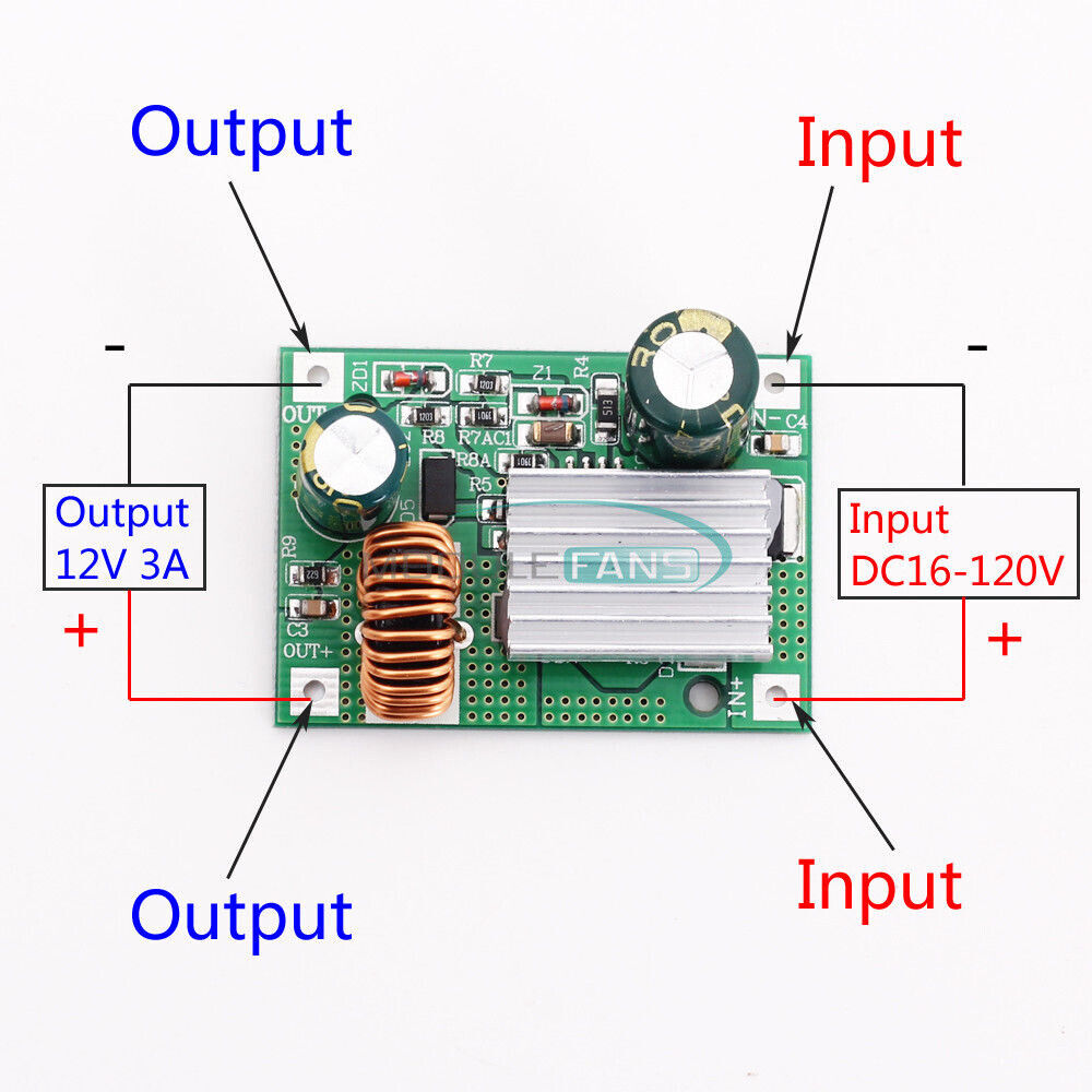

EDIT: I just realized that I'll need a 10VDC supply to use a torque sensor with 20S. Just have to remember that so I don't fry the CA.

OK, wondering if this would work for the 10V supply to the ERider PAS, since I'm running 20S. I have a couple of these small buck converters around that I got for lights, but never hooked up. This should get me down to 12V. I also have a bunch of silicon rectifier diodes around, so thinking of just putting 3 in series to get down to the 10V. Not sure what others have used since I don't see too many options searching around, but thought this would work without having to buy more stuff.

I used this one:
https://www.amazon.com/gp/product/B074JBZ63Z/ref=ppx_yo_dt_b_search_asin_title?ie=UTF8&psc=1
https://endless-sphere.com/forums/viewtopic.php?f=3&t=66489&start=2250#p1693980
I use the CA for most functions, but use cruise control using the controller since I don't like auto-cruise. I also use the 3 position switch on the controller, since high applies field weakening, so the CA couldn't control that. Using cadence PAS with the CA now, but am upgrading to torque sensing PAS next weekend (waiting for some chainring bolts to arrive).
