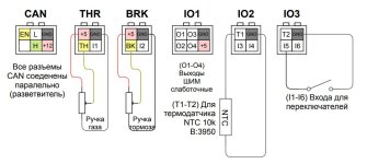

I think I have my brake cutout hooked up incorrectly. Both the throttle, and brake are connected to the uLight. The diagram has 3 wires going to the BRK port. My brakes only have 2 wires. I hooked my brake up between GND and I2. The controller is not seeing the brake. I'm not noticing a problem with the throttle.
In that diagram, BRK is a variable input, a potentiometer, just like the THR input is. Presumably so you can have variable regen braking in DD hubmotor systems.
I don't know if it is programmable to react to just a switch, but if it is, you'd probably have to change that setting to react to a zero input rather than a full-scale input to work with wiring signal to ground via a simple switch.
Hello,
Yes, you can definitely connect the brake to GND + I2, but you'll need to configure it on the controller. Let me know if you're able to set it up, or I can send you instructions if needed.
I was coming to that conclusion, but trying not to because I've never known of a bike that braked like that.
