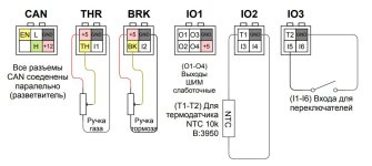

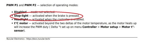

I finally got the last part I was waiting for, so now I can finish hooking up the rest of the controls, and lights. I think I'm on top of the rest of the wiring, throttle, brake cutouts, kill switch, and lights. The part I'm dreading is the set up. The set up manual is 30 pages, half of which I barely understand what they're talking about. I did find evidence I can operate my brake light if I can figure out how to enable it.
I'm guessing PWM P1, and P2 are 101, 102.
