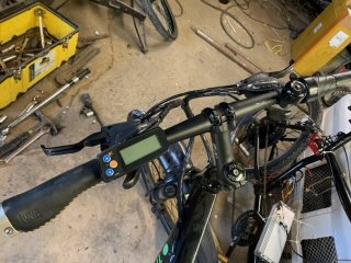

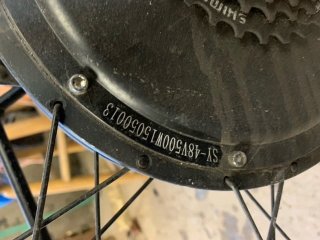

while looking to buy a used battery, i stumbled upon and ebike and ended up buying it
(i should mention here that ebikes seem like a drug, i started with one 15 year old crystalyte front wheel, and now own 4 ebikes)
anyway this bike was adv as not working, no charger but i hoped the battery may be ok. so for 200$ ive now got a whole bike instead of just the battery.
rig a charger up and charge it, fix a loose connection and seems to work just fine. rolls up to about 20mph just fine (messed with display settings but couldnt get it it go faster, must be speed limiting) pedal assist works. (the contoller is 15amp max so perhaps thats it as well, smallest one ive seen)
im trying to figure out what it is. The decal says Trillium and a quick google search goes here http://www.ontarioebikes.ca/ . not much there but the logo looks right. looks to be a regional outfit that puts together ebikes form other components, maybe not even in business anymore
im wondering is anyone can identify what these components are from? im adding some pics, about the only thing i found was maybe a connection to iGo , as some serial numbers on the wheel are similar to one of their bikes
any info or thots greatly appreciated.
it looks like a very decent bike, disc brakes, good forks, very well built at the rear drop-out, pretty tickled it works.

That bike is so generic, it might as well be a kit homebuild. If you regard each of its components as no-name eBay stuff, you'll get on with it fine.

Chalo is about right. I don't see anything that indicates it is a closed-system OEM ebike (like Stromer, etc).

Back to the original question.... at a guess, it's a generic 500w DD hubmotor. what would be called a "9C clone" (nine continents, 9cont, etc), wound for a 48v system to give you around 20mph top speed in a 26" wheel. (meaning, even with a non-speed-limited controller, it probably wouldn't do much more than that unless you up the voltage proportionally). A 15A controller means around 750w max power, and that's probably really 15A peak and more like 10A continuous, but you'd ahve to test that with a wattmeter under conditions that would provide that much load to find out.
You can probably use the http://ebikes.ca/tools/simulator.html with the 9C 2807 or 2808 versions to figure out what the motor itself could do for you, given a different battery and controller. First simulate them with the ones youve got (or closest they ahve to them in the list if you don't want to use custom numbers), until you see that it gets you what you really actually get. When you find the motor that does that, then you can simulate with other batteries and controllers to see what gets you what you want out of it, then go buy parts like that to upgrade them, if that's your goal.
It's not a bad deal for a couple hundred bucks, since it works--the main issue you will probably have is that the numbers on things indicate its' probably about four years old, so the battery may have age-related capacity/capability loss in addition to those induced by whatever usage it has had.

wow, thanks a bunch, thats helpful info im sure this is the right place, i am in canada
i emailed but got an autoreply, closed for season, wouldnt be suprised if they are closed for good. hard to believe a successful company works like this.
its a strange mix of parts, almost certainly either slapped together stuff or total buy and put on a sticker, for what its worth, the decals look crap and almost afterthought. the bike itself is far better quality than the e-component i feel
the original owner said it hadn't run in 18 months and although it started, level showed low it would barely go and quit, showed 45.5V . charged it 4 hrs with a 3 amp charger, showed 53.5v i think iirc. went 10 min full batt/no pedal till i got too cold, no issues so hope its gonna be ok. the odo read 660miles, if it hadnt been reset, not much. i may open it to see what kind of cells its made from

Most likely whatever the loose connection you fixed was the only problem it had, and the sitting unused is what drained the battery (who knows if they charged it back up after their last ride). I would recommend, just in case the battery is unbalanced, to leave it on the charger after it finishes the charge for at least several hours, and preferably a few days, whenever you can be there to monitor it the whole time (in case something goes wrong, because as unlikely as it is to actually happen, any battery of any kind can fail dramatically at any time regardless of type, brand, quality, protections, etc).
If there isn't a problem, the best thing is usually not to open things up that you don't have to, because sometimes that causes problems in the process. ;) I"m the type that would open everything up just to see what it looks like inside, though I do this a lot less nowadays until something goes wrong or I need to modify it. :oops: If you might be using this in other than dry good weather, you might open things up to check waterproofing (or add drain holes at the bottommost points of anything that doesn't have them, because water *will* get into things you couldn't imagine possible :lol: ).

so some props to the bike company. the guy emailed me back with the specs of that bike.

MOTOR 48V BAFANG 8FUN BPM with Hall sensor ,
500W nomimal - 750W peak power .
CONTROLLER 48V 25A 9 mosfets
