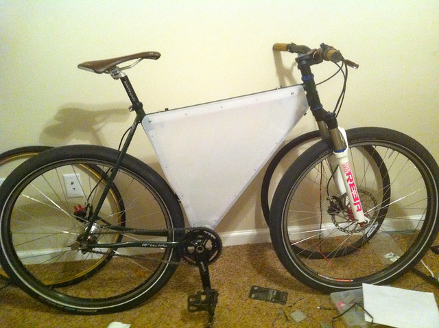

enclosure is made from 2" aluminum u channel I welded up.. It is removable. Bottom section is one piece which is help in place by water bottle mounts for positioning. Then the top piece of u bolted on the top tube. Lastly, some brackets secure the top corners of the framing, allowing it all to be removed easily.
I am making a triangle pack which is covered with 1/8" polycarbonate panels on each side. I am designing the shape to cut out with a cnc gantry router, but I feel like I need to incorporate some special shapes in... With something more intricate, I'd feel more justified using a $50k machine. For example: a high voltage symbol sticking out underneath down tube. I rather not engrave into the surface of the polycarbonate... rather would like to make "stencils" or modifications to the contour. Any ideas are welcome!
I am working with 24x24" clear panels.. I do not plan to paint the plastic.. Rather I'll just slide in whatever posters or color schemes inside.
I have not finalized the edges or anything in this picture...
24x24" artboard:
