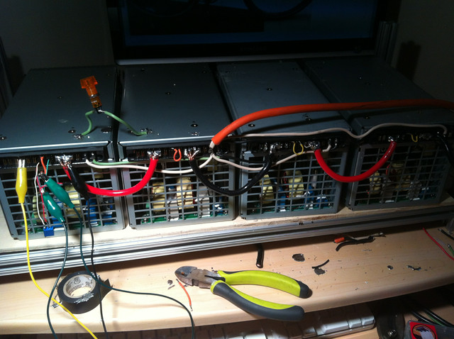

On the charging front, I picked up some scrap 80/20 aluminum from work to enclose 4 hp esp114 power supplies. I am getting a 25A draw at 50% SOC, so I wonder if it would reasonable to set LVC low enough to get reasonable capacity from pack but high enough that it doesn't blow the breaker. I may be able to get away without using a current modded meanwell, but just a microcontroller cut off (based on charging current and safety timer).
It'll be a pretty huge supply (26"x8"x11"), but it will allow me to grow with it (80/20 is easily reconfigurable)
