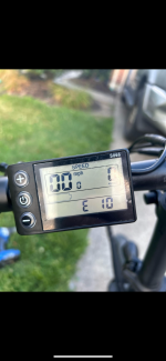

So I have a hit-way bk6m when I turn it on it did give me error e10 which is communications reception error and showing 0 battery I unplugged all the wires from controller and plugged them back in it now saying e 9 which is controller failure and if you leave the bike on and display the motor kinda clicks and wheel turns moving the entire bike a tiny bit repeatedly (not touching anything) also the controller is beeping red I have a new controller ordered but scared that won’t fix the issue and if it does the battery being full and it showing empty battery on display is still weird any help is appreciated thankyou IMG_0163.pngIMG_0191.jpeg
