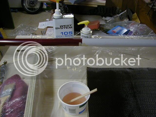

Lets make an "inatimate carbon tube"!
in this photo you see a 1.5" steel tube i used for a mandrel...its a left over form a job, powdercoating is incedental. We waxed it up real good & have it wraped with a few layers of waxed paper...only taped on the ends outside of the tube we are constructing. the CF is 5oz weight .010"t 2x twill pattern (on sale-ebay) & I am using west systems for this pc (its what i have on hand...other stuff is priced better)
Now we wet out the carbon fabric...this is the cool part, wetting fiberglass makes it disaper form view....wetting Carbon makes a black hole in you table top. increadble depth visual effect..photo's can't do it justice.I spread the resin around with a flexi spatula & make certain we have it all wetted out.
Next we cover the cloth with some plastic & really squigie out any excess resin....we want only enough to wet the fibers & any extra just adds weight.we can really push on the fabric through the plastic & force resin out between the sheets & contain the schticky schtuffs.
Now we wrap the mandrell with the cloth.....i worked slowly & rubed it down as being careful not to introduce any bubbles in the lay up...I am making a 7 layer wall tube & did the math for 2 pcs .....repeat the steps for the 2nd layer & really rub the forcing it into physical contact with the previous laters...I then squigie around the tube removing as much resin as possible while not starving any sections...its a visual inspection simular to brushing varnish...you can tell where a "dull spot" develops.
I have vacume bagging equipnment but given the simple shape of this tube I just carefully wraped it in more plastic drop cloth to maintian presure on the fibers & let her set for a few hours.
the streatch wrap secured the plastic at both ends, then I used a pattern wheel to make some holes in the covering anywhere i found pooling of resin...amazing how much comes out on a proper lay up.
the finished product, pulling off the mandrell is the work part of the project, can't stress enough about proper releas agents & resin proof backing on the mandrell.
thats 8oz for us amerikans. over sized tube
