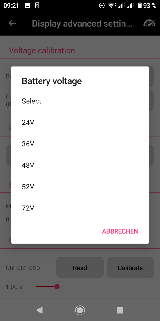

I read nearly the complete thread. But what I don't understand is the voltage drop with the led's. Is this a reason of the controller or the display?
If it is because of the display, does it work at a 20S 72V without led's if I want to run a eggrider V2?
At the eggrider app I could select a 72V battery. 🤔
With the stock display, it will cut off at about 61.5V. So it looks like maybe the Eggrider will get around that limit. What I'm not sure about is whether the 61.5v limit is monitored in the display or on the controller board. If it's on the controller then the Eggrider won't help.

btw.... What about the eggrider? Das this work out of the box with 72V 20S at 84V full charged? You could select 72V in the app. 🤷🏻‍♂️
The current draw on the low voltage supply does vary with operating conditions. Most of the change is likely due to the FET gate drivers. I measured between 25mA and 40mA depending on conditions, so a pretty significant variation.
The Eggrider itself may be fine at the higher voltage but I think you will still get an error if the controller sees over 63v.
