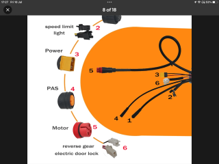

I have a etrike with a Bafang 750 watt G060 hub motor.
this motor comes with a red L1121 connector. I had this connected via an adapter to a Kt controller with a 9 pin power cable with black Juliet connectors. I had a joiner in this cable burn out and I assumed the Kt controller was cooked.

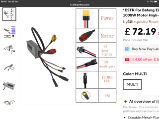

I looked for and found a controller with the same L1121 connector, this controller came as a package with a it4 cable and display.
all fitted and connected but no brake cut out or throttle working and Pas taking 3/4 turn to kick the motor.
I looked at the display and discovered a very limited set of display options. After research it became apparent that these “Bafang uart” controllers require a pc or android software and programming cable.
not a problem I get all this but all the instructions and examples are for Bafang mid drive motors.
The road speed meter settings do offer internal motor or by phase unsure which is correct and then speed meter signals ? On kt that was 6 again no idea now,
pedal sensor has weird choices as well.
Can any one please supply one of the .el profiles that speeed software requires for a G060 hub motor?
