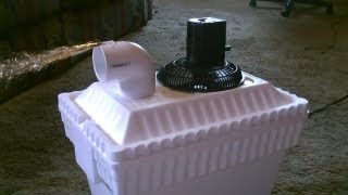

Check youtube - can make a simple "ice chiller" using a cooler and fan - they also sell 'em. Temporary at best but for some situations can provide relief.
