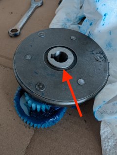

I'm building a special vehicle that has two wheels, but they are placed "side-to-side", instead of aligned in the direction of travel like in a bike. Something similar to a tricycle.
I want to put an ebike hub motor inside each lateral wheel, but I need to invert the direction of one of the wheels. The problem is the freewheel inside the motor, which I also need to invert.
I got my hands into a broken motor which I opened and saw that the freewheel mechanism was attached to the hub, and it was very easy to invert. Then I bought these two motors hoping that they would be built similarly. Unfortunately, the inside is pretty different and the freewheel is located around the axle:
So I don't think I can manage to invert it... I would need to remove those rivets (I believe they are rivets) and still I don't have much faith I can mount it back.

Weld the clutches.

They were referring to both the clutch of a geared hub motor and the freewheel of a hub as the freewheel, but I believe for their problem they simply want to have a non clutched geared hub motor- E-HP's suggestion of welding the clutch is probably the simplest solution.

Yep exactly, sorry if I used wrong names.
I welded the inner clutch and I achieved what I wanted! :)
The bad thing is that I lost the freewheel functionality in one of the wheels, but for a prototype is okay 👍🏻
