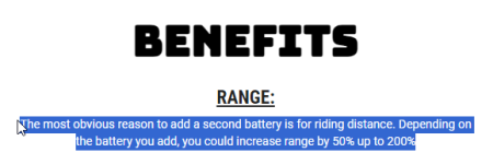

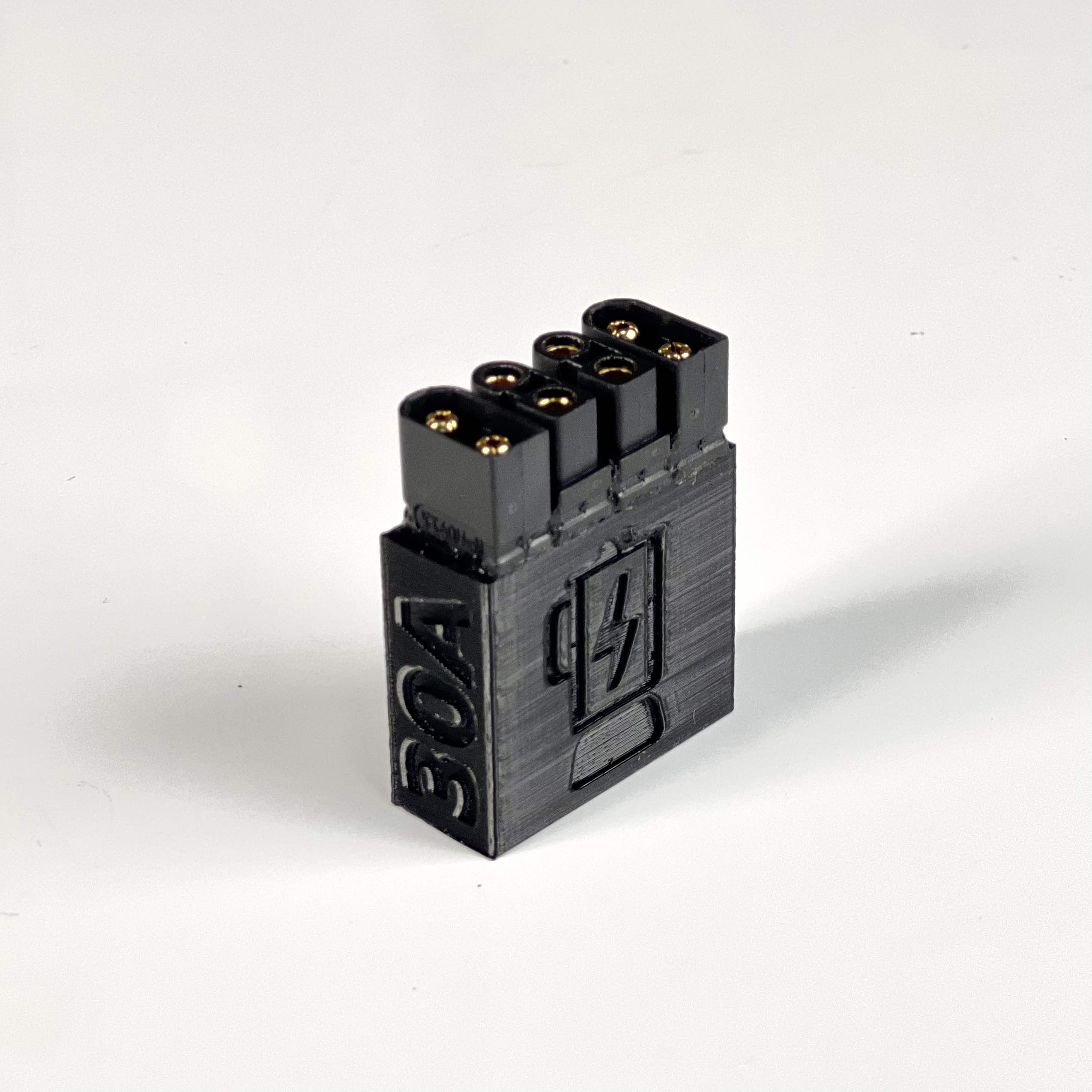

Warning. this is technically impossible. At most a lithium battery can tolerate 15-25% energy loss ( becomes heat ), depending on the chemistry, before catching on fire. It is technically impossible that such a device could save this much power because a battery would shut down ( hopefully ) or catch fire before that happened.
This would be the ideal device to stretch out an old saggy battery by pairing it with a stronger battery but if you are buying a new one, this isn't the case.
I'm kind of dubious now, i suggest you look for long term experiences with these before you buy; maybe they are legit but IDK.
When i see a seller making claims like that, i think this is more of a marketing company than an engineering company, let's say
