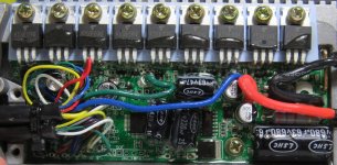

Hi
I got KT48SVPRM-XFCF06 (board KTE-9S5-J5). It has 9 transistors K150E09NE. Processor STM8S105C6T6. Current sensor acs711 (QFN).
Is it compatible with this OpenSource firmware?
What are the extra 3 transistors doing?
I think no one tested this..
Look at how the gates are parallel, I think it's like 2 paralel for high side and single for low side, so 6+3..
Where you bought this? I like that "design"
It is the controller which is built in a battery case (https://www.li-force.ru/shop/view/tube-controller-48v-20a) (http://www.szktdz.com/en/news_show.php?article_id=423).
