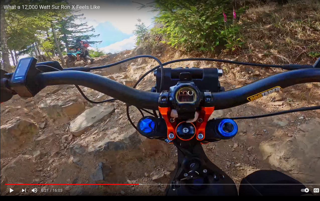

Here an example of SW102 being used on the famous Sur-Ron elecric dirybike:
[youtube]vrwv-lQwRJE[/youtube]
User discusses the advantages to use SW102 over any other big display, for his Sur-Ron offroad dirtybike:
[youtube]A_fL_Fblvbw[/youtube]

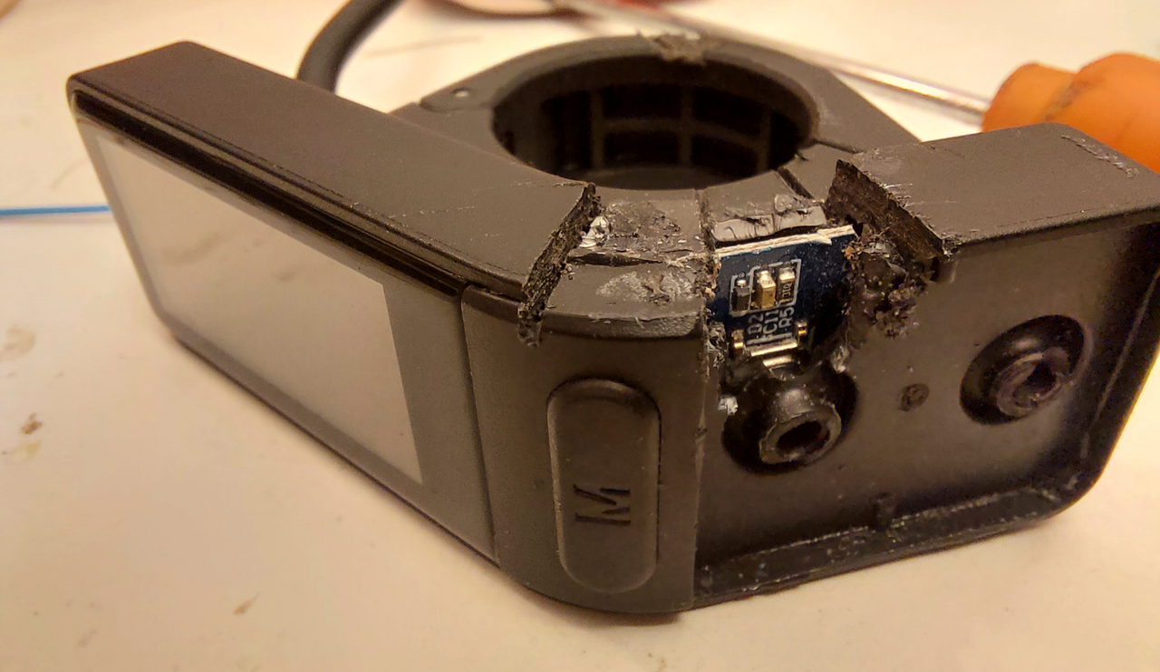

I bought a SW102 display to install on my cargo bike with TSDZ2. While following the process to open this display to flash the bootloader firmware, I destroyed the display because I was counting to have the flash pins on a place and there was not, because this seems to be a different board :-( :-(
Older board:
Some other board version:

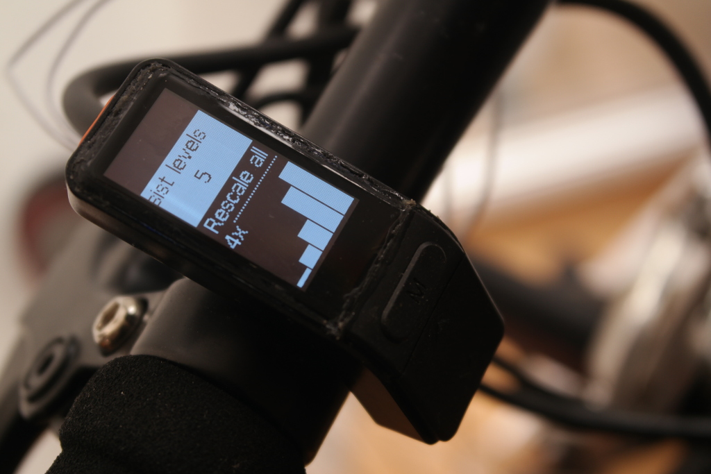

So, I decided I will not invest more on SW102 and instead build a display using similar OLED display with similar size, and I will reuse TSDZ2 wireless board for which I will only need to solder extra 4 wire for the popular cheap I2C OLED display. This way I will reuse the firmware we did developed for SW102, as the microcontroller we are using is similar but more recent and powerful.
Would be sad to lost the firmware we did develop:
[youtube]q0N5W3Fgyjk[/youtube]
This is the current TSDZ2 wireless board (that can also easily done DIY, without this custom PCB):

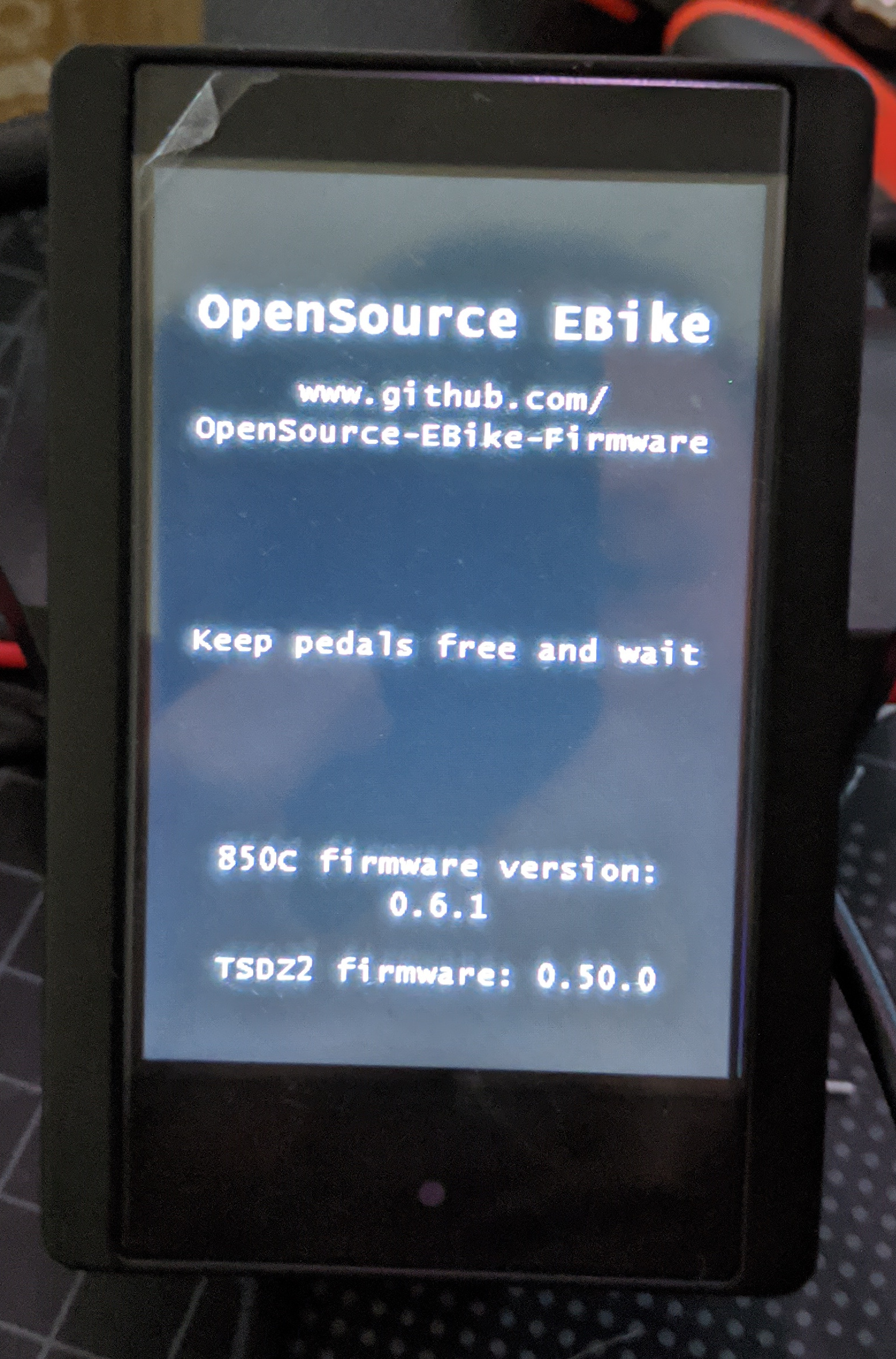

Happy New Year!
I've been reading this forum for quite a while, first time poster though - holidays have given me the opportunity to dive in and replace the LCD (now 850C) and firmware on my TSDZ2.
I can't seem to get the 850C LCD to power on without holding down the power button. Am I doing something wrong?
Holding down the power button shows a successful negotiation between the controller and LCD, firmware versions are displayed - however, the screen appears stuck there. It never progresses to any other screen, and releasing the power button powers off the display. Pressing the other buttons appears to have no effect.
850C Firmware Version: 0.6.1
TSDZ2 firmware: 0.50.0
Both downloaded from here: https://github.com/OpenSource-EBike-firmware/Color_LCD/releases/tag/850C_v0.6.1
Voltage measured with a multimeter between ground and blue/brown join is 50.4V, and between ground and red/orange join is 48.6V while the button is held down, 2.13V when not. The LCD reports around 48.2V before the text is replaced with the TSDZ2 firmware version.
I've double-checked my wiring in accordance with the wiki. I've tried powering from both battery and a bench power supply, and I get the same results. I've tried unplugging the battery and letting it all sit for a bit, no avail there either. I've also tried re-flashing the firmware on each. Hoping I've made a simple mistake somewhere?
Thanks for all the work on this project done by all, and for your suggestions in advance.

Because 850C / 860C display are expensive, suddenly fail and were done to not be repaired, I now have our simple, DIY, easy to repair display, based on the SW102 display. It works very well but still needs some more firmware development, mainly to refine some things.
https://github.com/OpenSourceEBike/ev_display_bluetooth_ant
Here is a video of the display working on my EBike with TSDZ2 motor:
[youtube]viimR74NPZk[/youtube]
I did the 3D printing enclosure in a way it fix to the handlebar in a similar way of the Garmin GPS displays, using the elastic, so should be easy to fix on any handlebar position.
On the bottom there are 4 small screws on the corners, to easily open in the case of needed repair:
