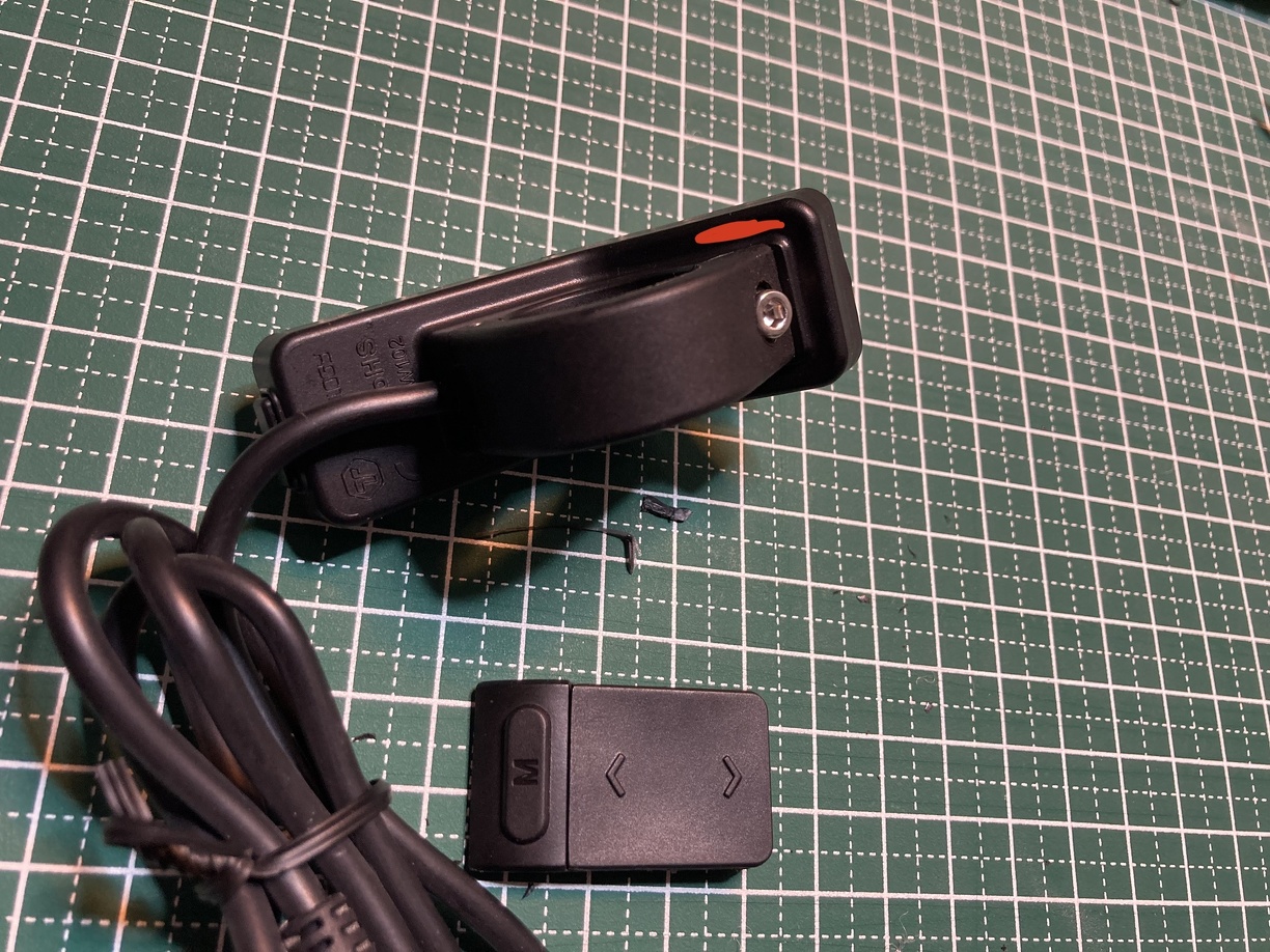

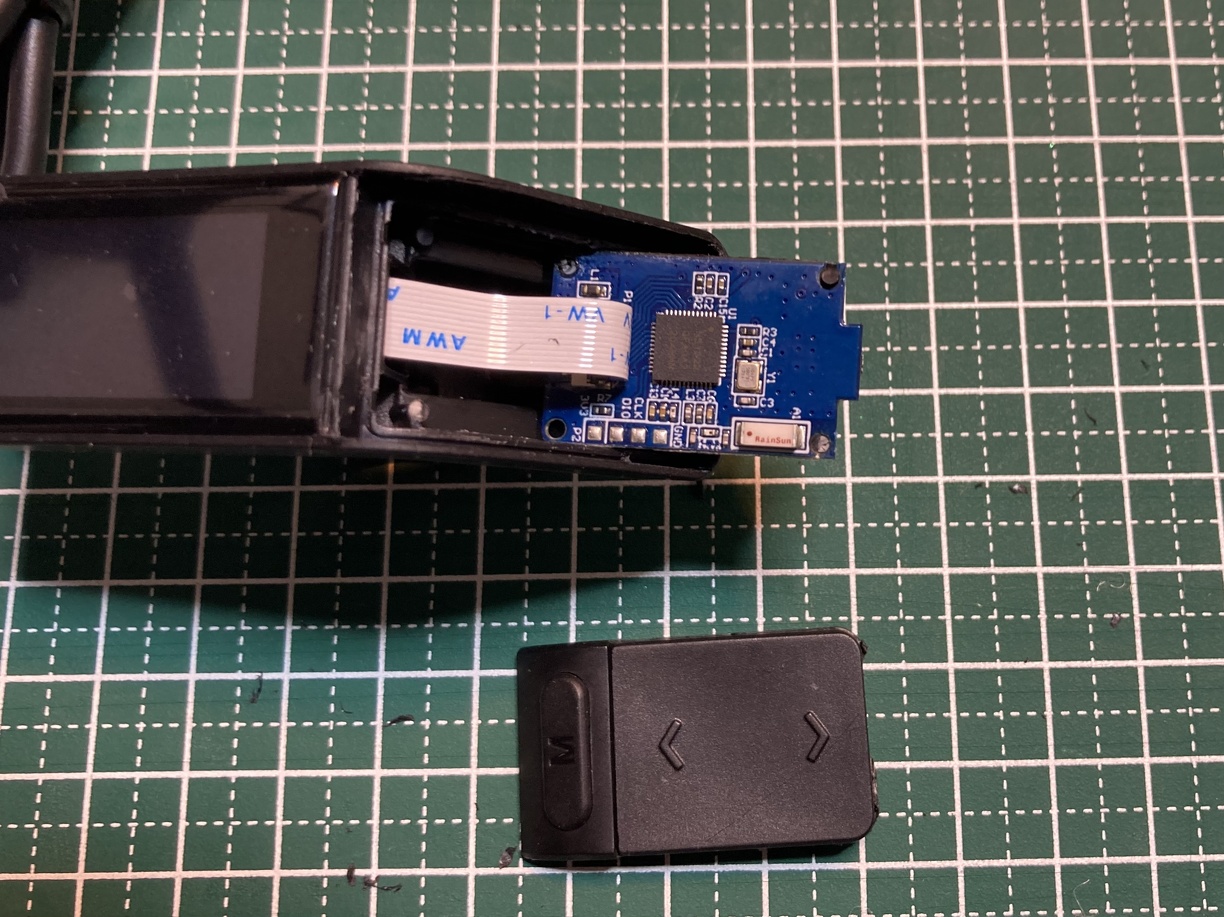

Newbie to the SW102 displays, and I bought one before reading about the second PCB variant. It arrived in the mail this week and sure enough it was the second variant. But I did some fiddling and I think the second variant is actually preferred over the first one.
I did the chop around buttons method to open it up from the keypad side and as casainho has found there are no programming pads on the top PCB surface.
i.php
However, after some prying and then cutting the PCB mounts off with a flush cutter the PCB can be flipped over and the programming pads are on the back:
They are super close to the edge of the casing there, and effectively down in this lower corner of the case:
I think with some careful dremel or knife work it will be trivial to reveal the pads on the new SW102 v3.1.1 boards, and will actually be easier than the old method to seal back up. A bit of silicone or sikaflex on the underside will easily keep it waterproof and you are going nowhere near the buttons or the top surface.
Will attempt to program it later today and report back on that.

it's easy to distinguish both versions of the SW102: The cover of the up and down-keypad (without 'M'-Key) measures 20mm on the old vs. 26mm on the new version. So the new version is slightly bigger.

Meanwhile I can also confirm that the new version of the SW102 seems to be fully compatible with the OSF.
