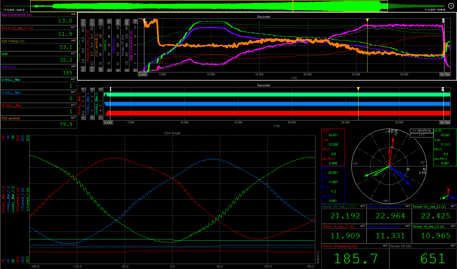

Here's a some early stage shot when battery current was limited to 13A.. first with throttle to accelerate at full speed (without load) then gradually braking to go for current limiting point.
Over all very impressive test drive behind. I had only a small torque pumping in couple of first pedaling s, witch i believe to get fixed by pid tuning.
Next phase i have plan to add some functionality to walk assist and cruise functions. I will to ask what is the suggested place to give or manipulate some fixed torque request by user while pressing a buttons?
Also in some point during dev the lcd6 out temp started to showing constant -22 C°
Did some one known which way it measures a temp? inside button enclosure there was a component printed "TEM".. perhaps that was a some short of thermistor? at least i have infinite resistance over it!
Best regards,
Tepa76
