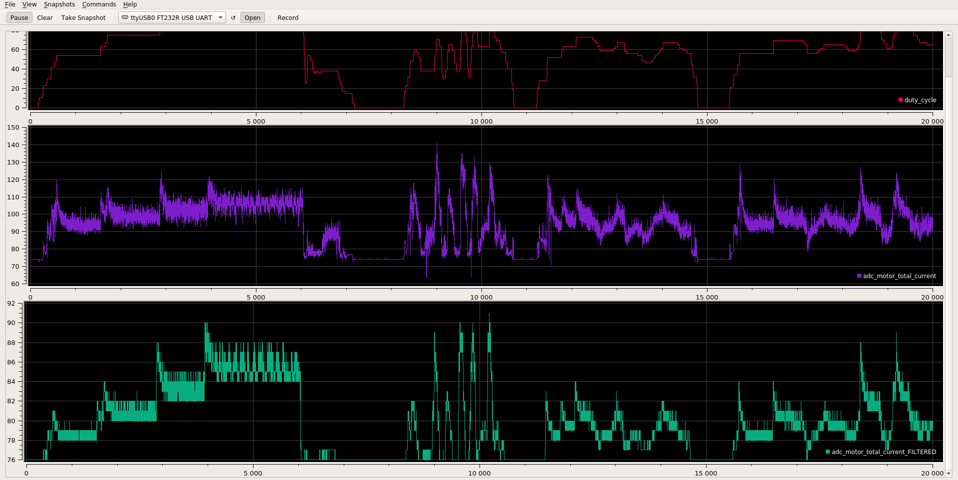

Stancecoke, about the PI controller:
Code:
void pi_controller (struct_pi_controller_state *pi_controller)
  int16_t i16_error;
  int16_t i16_p_term;
  int16_t i16_temp;
  i16_error = pi_controller->ui8_target_value - pi_controller->ui8_current_value; // 255-0 or 0-255 --> [-255 ; 255]
  i16_p_term = (i16_error * pi_controller->ui8_kp_dividend) >> pi_controller->ui8_kp_divisor;
  pi_controller->i16_i_term += (i16_error * pi_controller->ui8_ki_dividend) >> pi_controller->ui8_ki_divisor;
  if (pi_controller->i16_i_term > 255) { pi_controller->i16_i_term = 255; }
//  if (pi_controller->i16_i_term < -254) { pi_controller->i16_i_term = -254; }
  if (pi_controller->i16_i_term < 0) { pi_controller->i16_i_term = 0; }
  i16_temp = i16_p_term + pi_controller->i16_i_term;
  // limit to [0 ; 255] as duty_cycle that will be controlled can't have other values than that ones
  if (i16_temp > 255) { i16_temp = 255; }
  if (i16_temp < 0) { i16_temp = 0; }
  pi_controller->ui8_controller_output_value = (uint8_t) i16_temp;
I was having a delay sometimes and so I though there is no point to let I term go to negative values and keep it having only values from 0 up to 255. I tested again it now seems to be working as I expected, without that delays.
I am being testing the firmware, on the 2 different ebikes with 24V battery, S06S controllers, Q85 geared motors, LCD5 and torque sensors only. In fact, my soon and girlfriend did ride this ebikes on this weekend for about 20kms. Everything seems to work well :)
Yes, I am really being testing the ebike with our firmware and this bicycle is really strong :) -- that was yesterday and everything went ok:
This was some hours ago, a ride of 20kms:

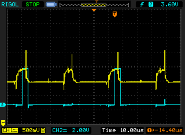

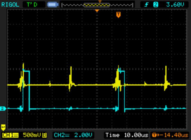

Dont understand yet exactly how it works.. but does that mean the model(50,100A..) does not matter really if we dont use it for limiting?
See this chart.
honya96 said:
casainho said:
See that on firmware, we use only the sensor output voltage (for "FOC") near 2.5V output (0 amps), so I would say would be no problem if the sensor is working on overcurrent.
We are looking for zero crossing of the wave of current, when it changes from a positive to negative value.
Higher current sensor is less sensitive to lower currents, so I would say an S12S should be used for powerful motor that asks more current than one used on S06S.

I think I got the motor phase current from the shunt, by following the ST application note. I also did some tests and did a log, where I did validate the results with the mathematical model.
My notes: https://opensourceebikefirmware.bitbucket.io/development/heets_and_application_notes--Endless-sphere.com_forum_messages--2018.02.20_-_Reading_motor_phase_current_from_the_DC_link_current_(shunt).html
Following the application note: Linked file: AN2267 - Implementation of current regulator for BLDC motor control with ST7FMC.pdf
it should be possible to read motor phase current with “satisfactory results” from DC link current (shunt current).
The PWM interrupt code was changed so the interrupt always happen at the middle of current pulse. The ADC channel 6 reads the pulse value at start of interrupt and after all the other ADC channels are read.
Note the line debug_pin_set (); that is when ADC channel 6 read happens and will enable a digital pin so we can see on the oscilloscope.
And on oscilloscope, blue line is the digital pin signal used for debug and as we can see, the pulse (yellow line) is read by the ADC right on the middle.
Yellow line is shunt voltage (after amplification).
The next pictures show different current values and that signal is always read at middle.
Note that the firmware only reads 1 pulse every PWM cycle while there are 2 pulses every PWM cycle.
And log from real values:
Validation
Example of point on the graph:
- duty_cycle: 85 (33%)
- battery current (green line): 82
- motor phase current (purple line): 100
- lab power supply was measuring 2.5 amps
1. Battery current was 2.5 amps. The green line had a value of 83, which is a delta of 8 (83 - 75, where 75 is the ADC value for 0 amps), so every ADC step is 2.5/8 = 0.31 amps.
2. The motor phase current had a delta of 25 (100 - 75), which represents a value of 25*0.31= 7.75 amps.
3. The mathematical model says that: battery current = duty_cycle * motor phase current. As the duty_cycle was 33%, so the motor phase current should be (battery current / 0.33) = 2.5/0.33 = 7.6 amps <--- the measured values seems to be inline with the mathematical model.
