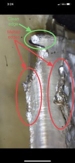

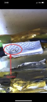

I performed a much closer inspection of the severed tab interconnect in an attempt to more definitively diagnose the cause of the disconnection since there seemed to be conflicting evidence. Closer inspection behind the tab folds revealed burn marks and melted edges. Although I agree that the lack of strain relief on the balance wires could be a problem, and may have contributed to the genesis of a traveling tab failure, it appears that excessive current overwhelmed the tab, melted it, and caused arcing.
Something interesting I noticed was the burn mark pattern. There appears to be a row of burn mark dots. I wonder if a new burn mark was created with each Kweld use, consuming a little more of the tab each time.
I used a special digital camera-microscope to try to photograph the burn marks and melted tab edges. The resolution is a bit low, but the damage is still visible.
I’m curious about your thoughts with this new evidence.
To me this looks like overcurrent as well as some damage during assembly. I'm not sure what the inrush current looks like from the kweld but it's looking like too much for how this pack was soldered. I expected better but to be fair this is also likely being used outside its normal design envelope.
What you labeled as splatter looks like melted aluminum to me. If you tig weld dirty aluminum it can look like this if the cleaning % isn't high enough, the shielding gas is weak / contaminated, or the metal / fill rod is dirty.
The row of dots might be the diamond pattern playing a role in conducting / insulating / not handling heat as well. It might also be thinner in the divot of the diamond and easier to melt there.
Oh wow yah I bet you’re right about the Diamond pattern! That would explain the uniformity of burn marks. Nice observation!
So I had a suspicion about that diamond pattern and how it relates to the tab welding process. It seemed to me that in order to achieve a spread out diamond pattern after an electrical resistance weld, an elaborate cascade of individual welds would be necessary to avoid using enormous current for a single weld instance. All of that seems way too impractical for a high output manufacturing setting.
Turns out those battery tabs weren’t spot welded, they were joined using a process called Ultrasonic Metal Welding (UMW). That diamond pattern is a result of the “sonotrode” clamping down onto the battery tabs against an “anvil,” at which point a vibration welds the tabs together. It’s a really cool alternative solution for joining metals, but unfortunately the equipment costs thousands of dollars.
