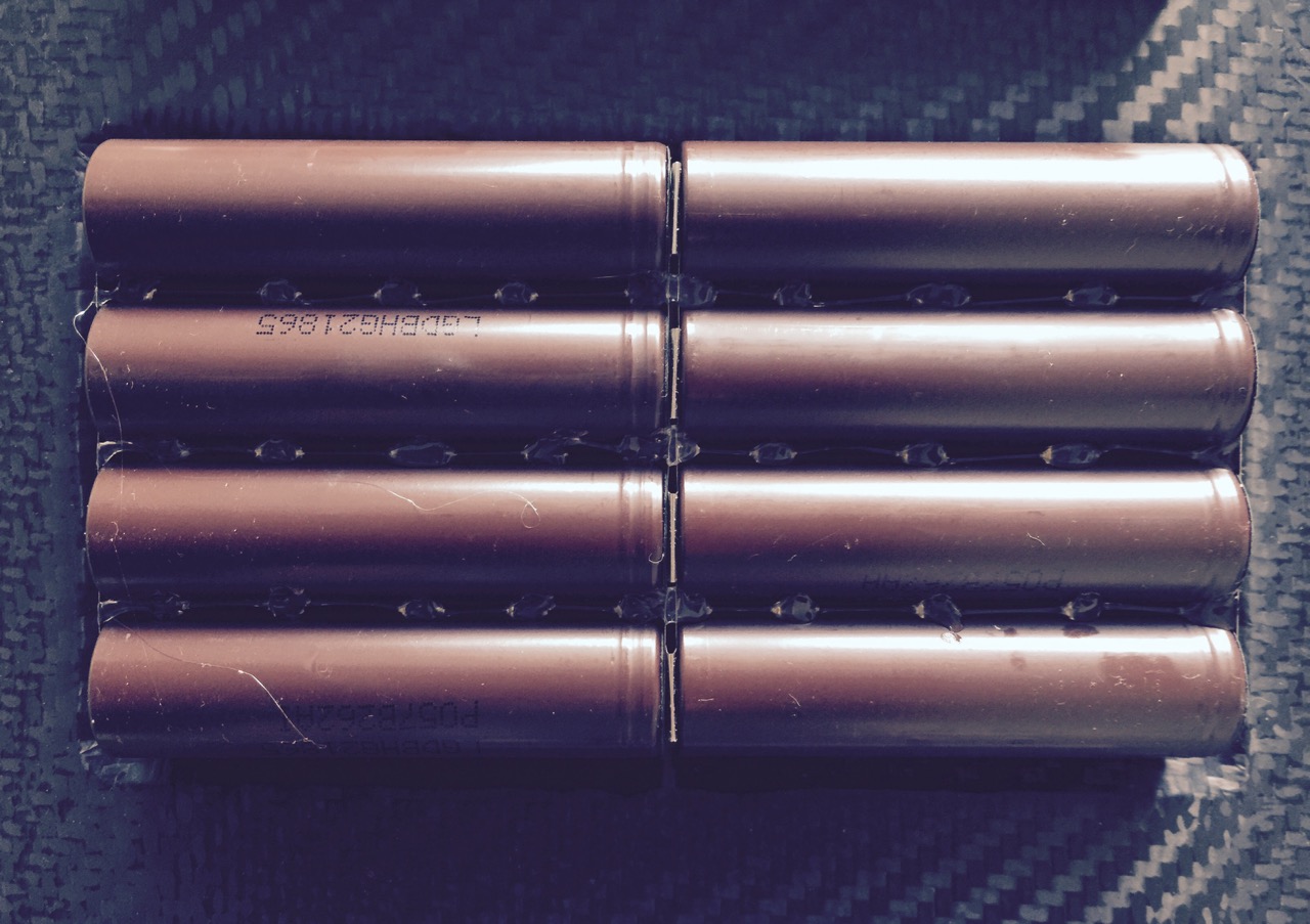

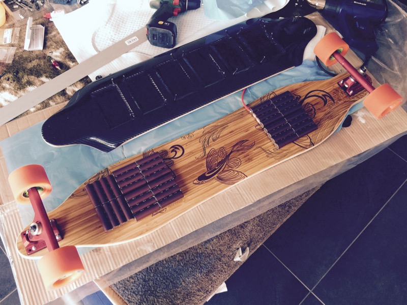

after my 3dm avila diversion, I got my 40 LG HG2 cells today. must say, I grew to be a real fan of that cell, it has near perfect stats for the 10S4P battery size in my opinion.
this time, following several remarks of the pedelec pro battery builders and randyc1's first build, I ordered cardboard stickers from the US to give some additional protection to all cell's plus poles:

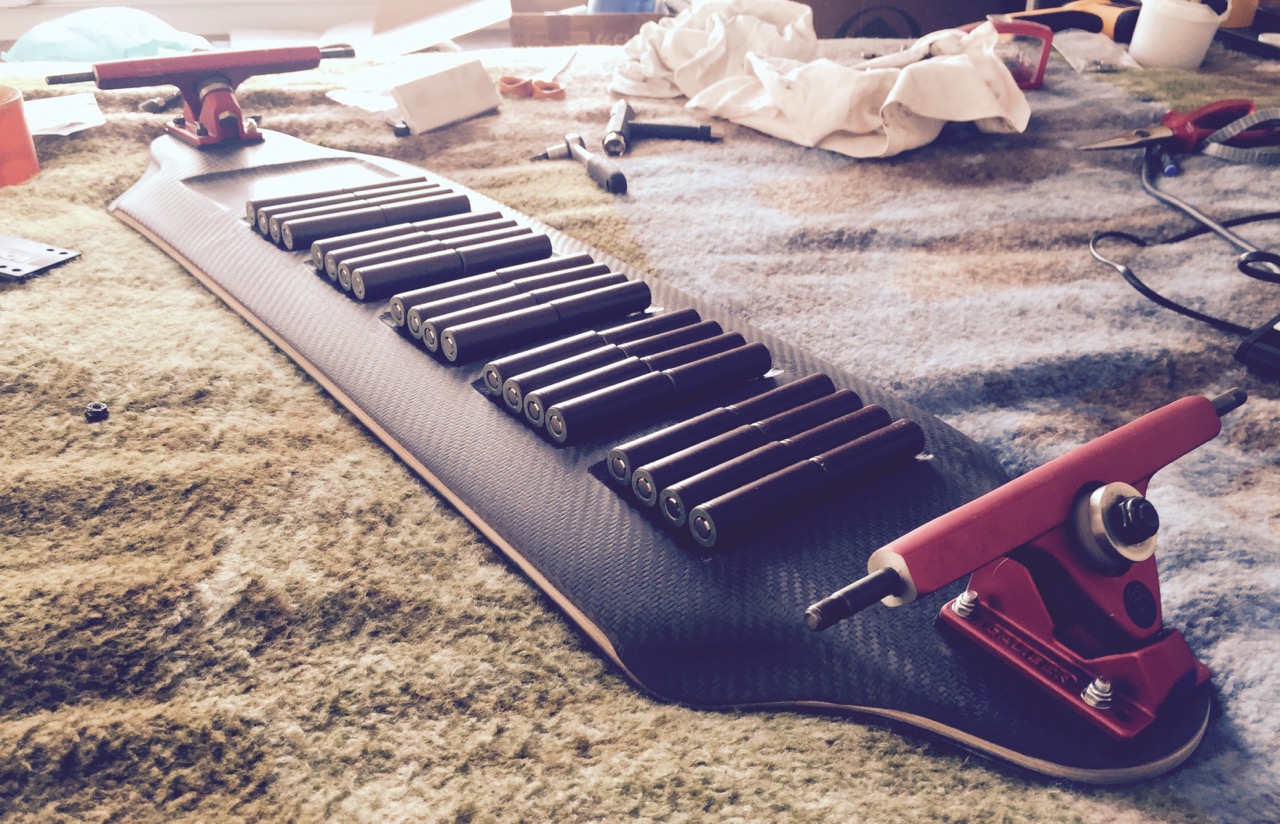

not sure if Ill start welding tonight, spend the whole day in a cable park and can barely move my lower arms :lol: also, Im not 100% sure yet which battery layout I prefer - middle connections or not.

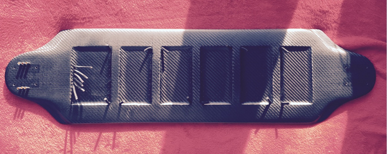

whats also still missing is the enclosure. I have the problem that I want 6 pretty much identically shaped boxes, each with 2 rounded edges of 20mm radius to accomodate the cells perfectly. Im not really sure how I am supposed to do that with wood and my tooling of a hand saw and a vibration grinder. :?

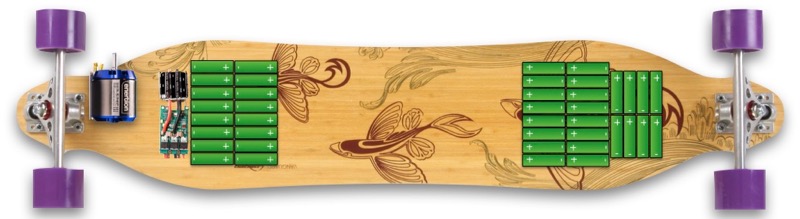

Hi whitepony , so your not sure if your going to wire it like last battery pack or like your new diagram on page 9 ??, is that what you mean ?
The new design has the advantage of Pos & Neg at same end ,.. but will probably require a slightly larger enclosure due to having 2 thick 10g flex wires facing each other on the insides of pack,... unless you can solder 1 on the top part of 4p and the facing 1 on the bottom part of other 4p ?, otherwise it will be just slightly wider.
Looking forward to seeing this new design, looks awesome !!

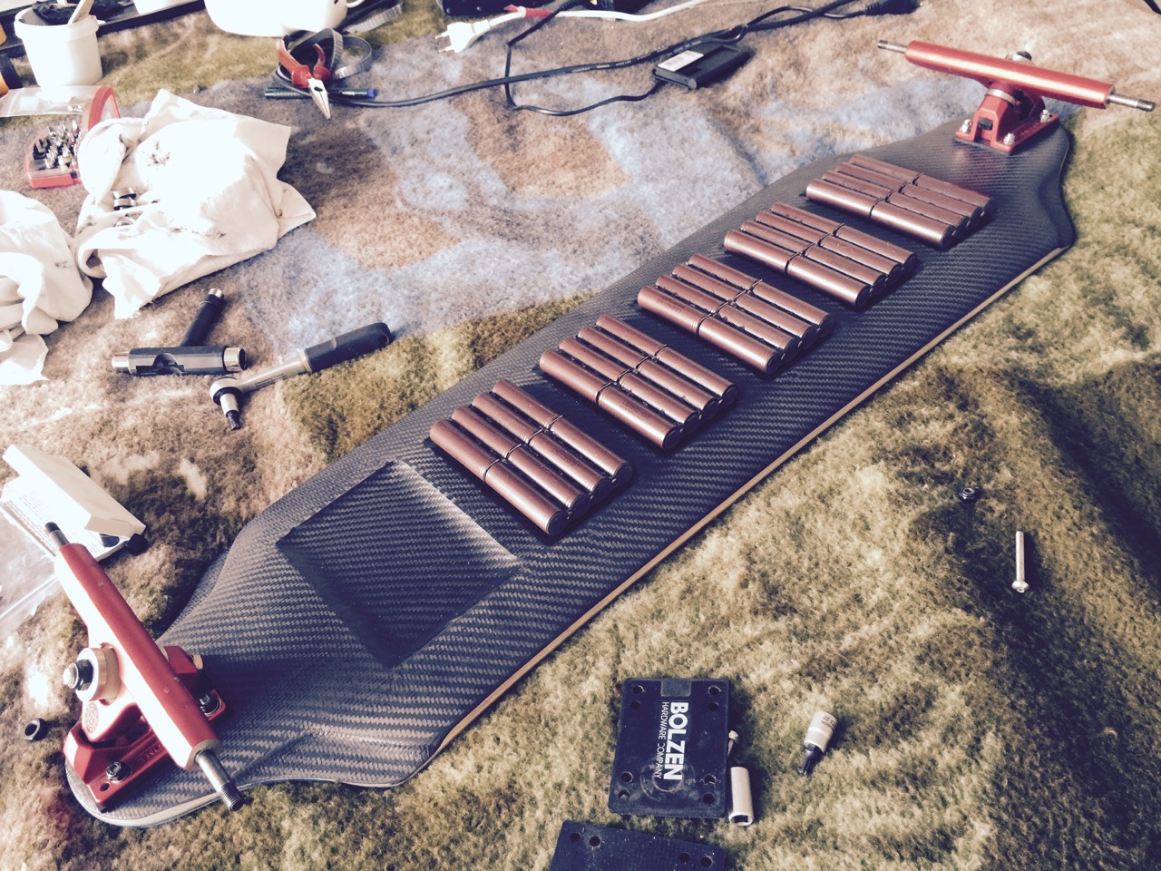

the biggest problem of the new design is, that within one chamber, the 2x 4P packs need to be isolated and may not touch. I wasnt a big fan of that and, after some contemplating I just went with the old design. since Im skipping balance leads for now with the odd maintenance session every few months, the nickel strip serial connections after butterfly folding allow a really tight pack:

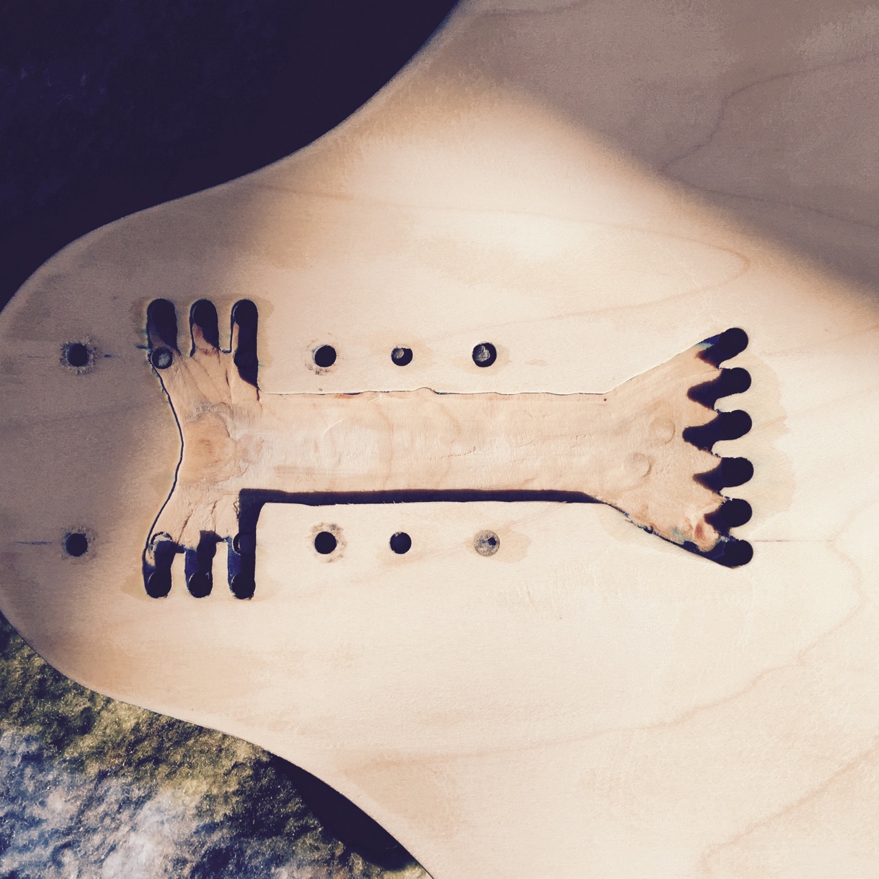

I again added the soldering spots for solder wick copper support of the serial connections, but right now im hesitant to attach those yet because Im not sure yet how I want to do those connections. I could route channels and connect each chamber roadside OR I could drill a hole from chamber to the topside of the board and route a channel there.
problem of no1: Ill have to think about something to bridge the channels everytime I want to vacuum an enclosure. didnt do the board with integrated channels this time, cause I still didnt have better foam and I didnt want to have weird looking deformations. ah well, think Ill probably go with drilling and routing on top of the board, some for the esc-segment to motor connection a la longhairedboy. little afraid to go with bare copper through carbon though, so Ill have to go solder wick -> 10AWG -> through the boards carbon.

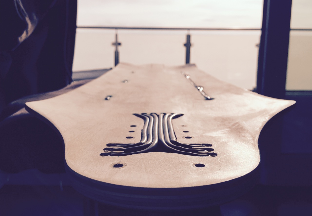

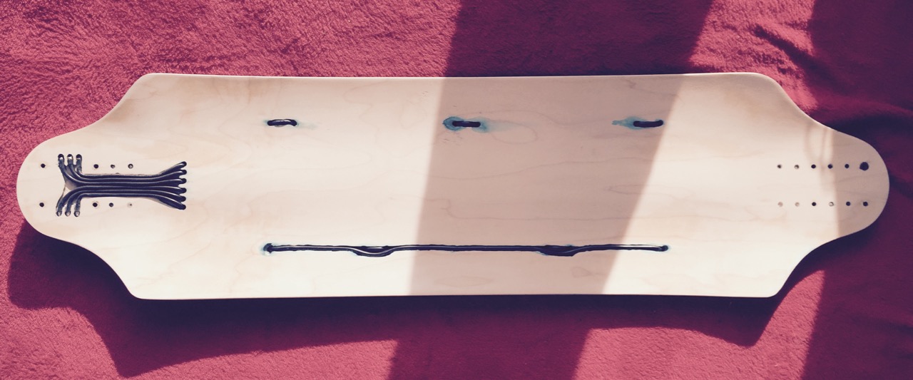

ok, today I went for it - removed the griptape and started routing with that handheld devils router, what a bitch, I never want to see it again after Im done :lol:

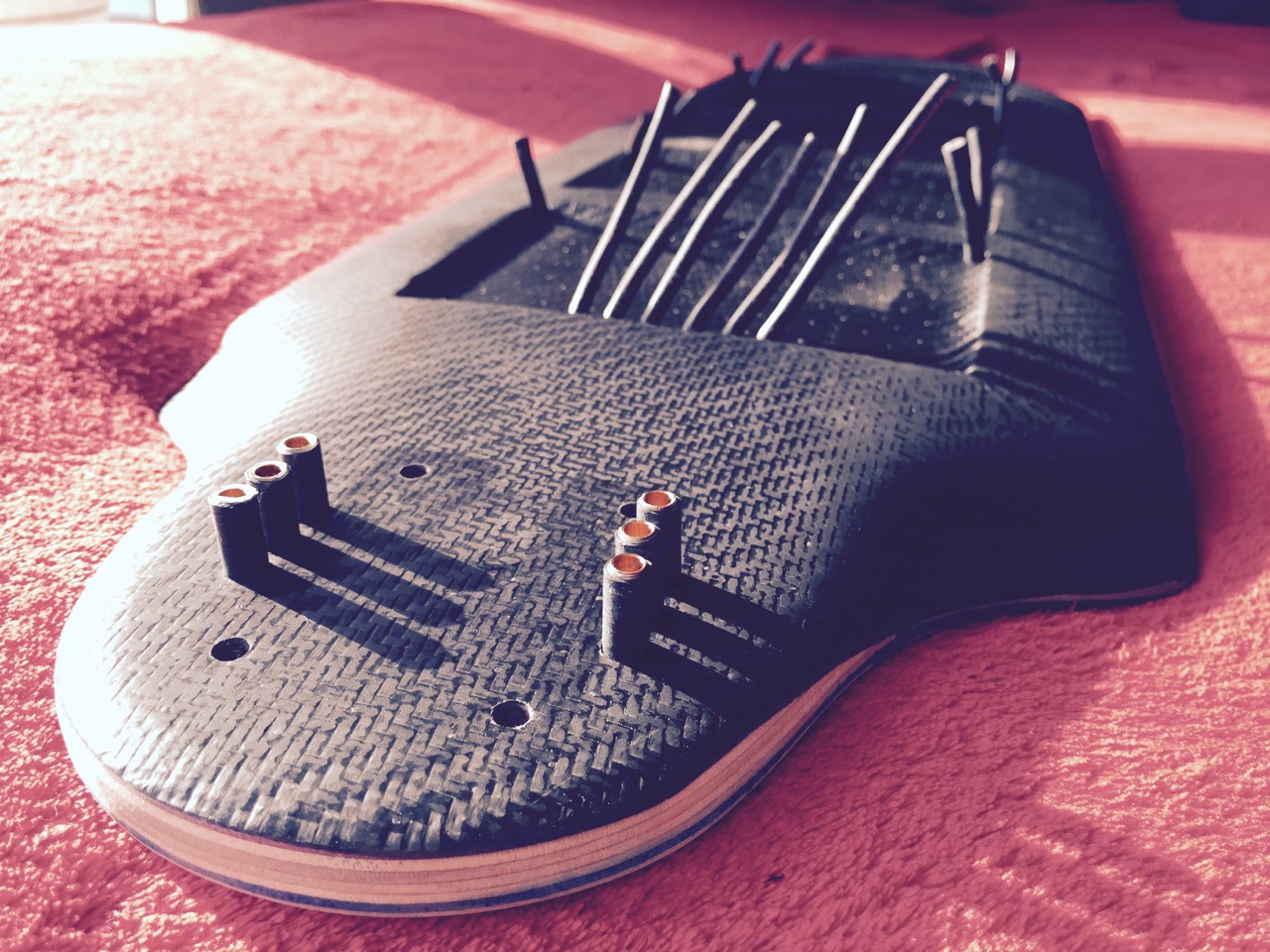

anyway, following longhairedboys builds, I routed the channel for the 6 phase wires and let them exit next to the trucks. I wish I had cmatson somewhere close, but my shaky drummers hands had to do the job somehow :p
routed the channels for the serial connections of the battery - also of that looong minus pole cable, since I went for my old layout. then I added 10AWG wires for the battery and 12AWG for the phase connections and everything started to look a lot better already :p
cable exits on the other side:
closeup of the phase wires:

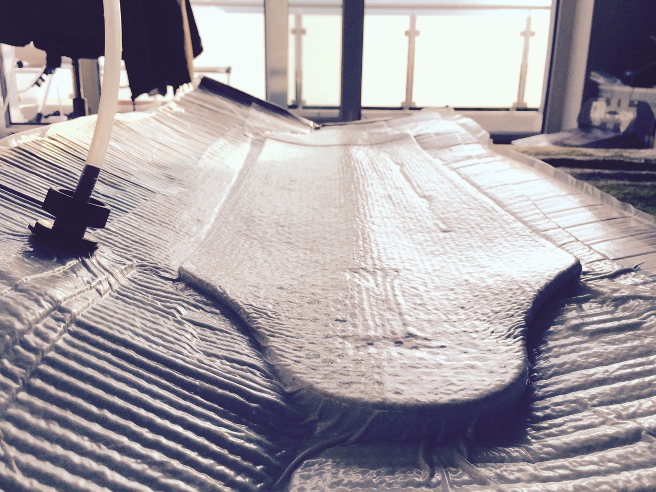

stuff is flat enough for some vacuum bagging!
filled up the channels with epoxy, then added 2 layers of small GFK patches ontop of each cable channels + one complete GFK layer on the board:
Ill sand that one its cured and fill up the last bumps stuff with elastic filler before I add new grip tape! :)
