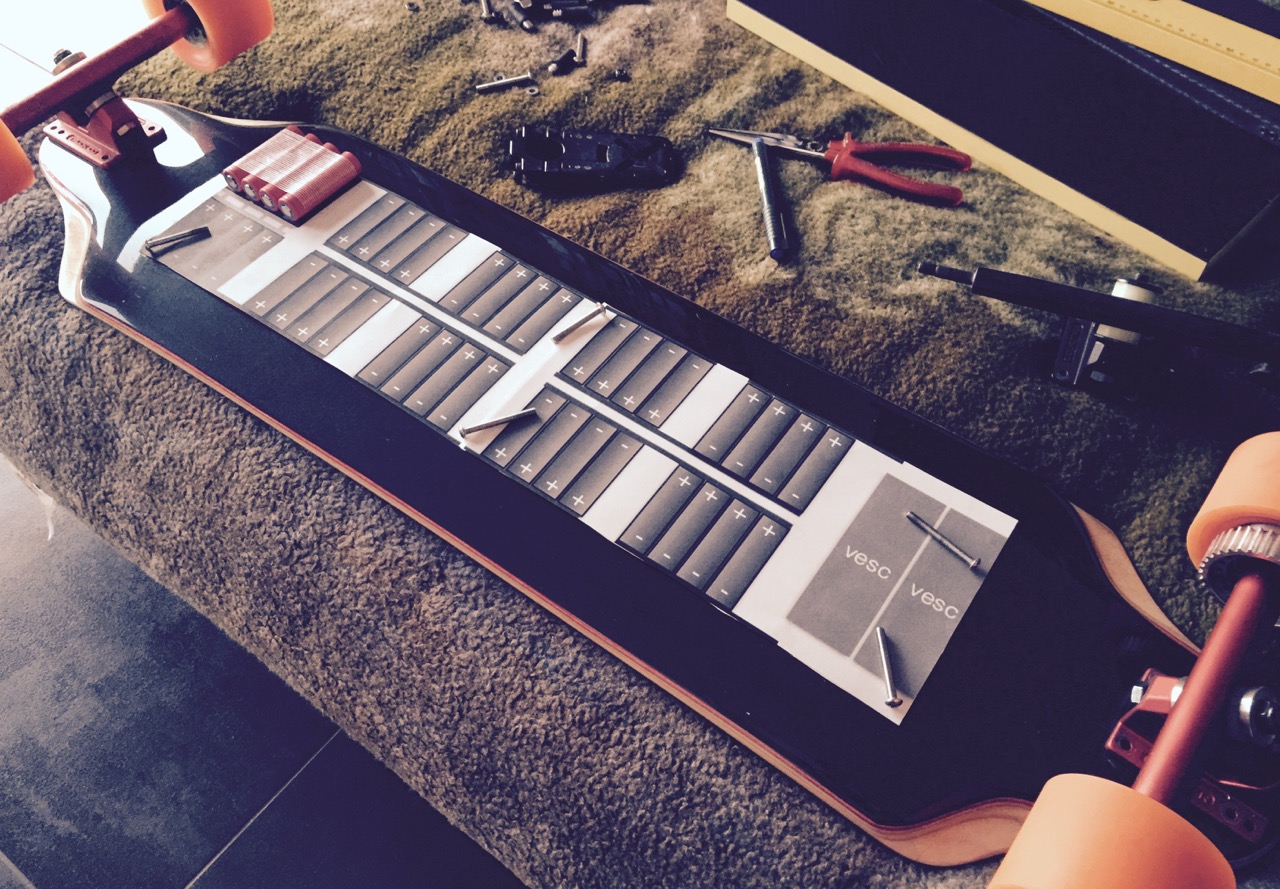

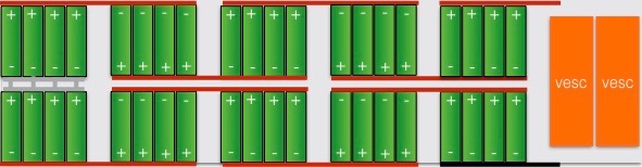

look at this layout:
you can see several things: first of all, plus and minus pole reaches the vesc at ONE end of the battery (a good idea of elkick), second all the parallel packs have 2cm dividers, and each battery chamber is connected by superflexible silicone 10AWG wires, which allows the battery to follow the full flex of the board, no matter how hard it flexes.
the carbon enclosure will be one piece, with board level connection to the board on each divider and chamberheight of 1.5cm between the dividers. that way, the enclosure can follow the flex of the board perfectly well on each divider segment, while all the chamber segments with finite enclosure height will be stiff again.
I plan to sink in each chamber by about 0.5mm with my colleagues handheld router, put 1-2 layers of carbon on the board because its structure will be severely weakened, then form a 1-piece enclosure, using the board and 6 small wooden blocks as positive form.
more tinkering coming up :D

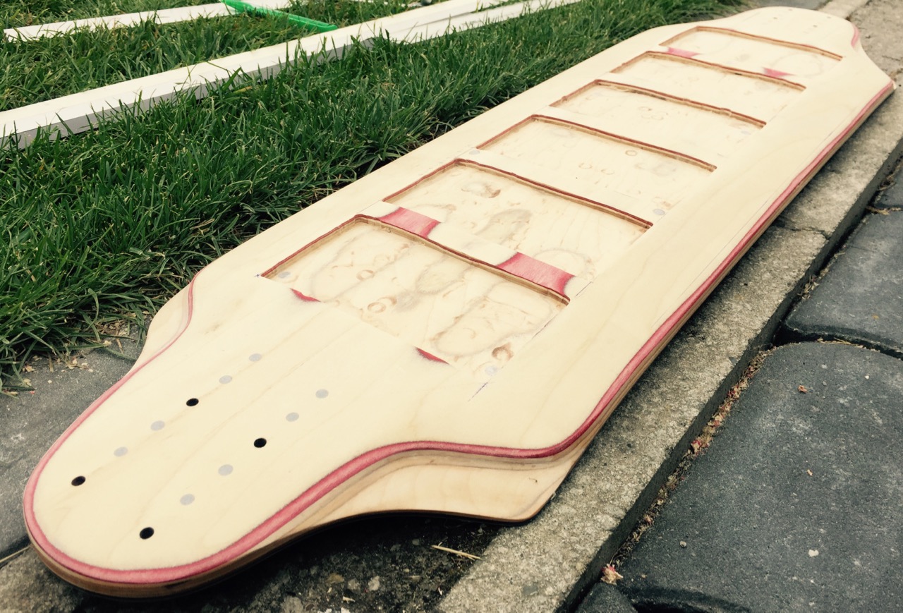

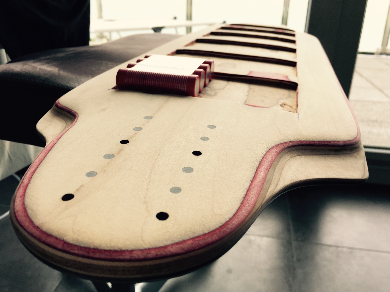

basically I prepared the board for carbon. I think I really removed a LOT of wood, so I better use 2 layers of carbon and more if thats not enough.

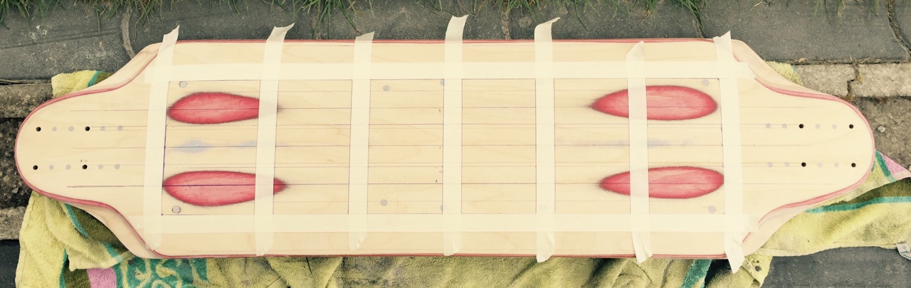

sanded and everything measured. Im using very long, thin aluminum flat profiles that bend fairly well to draw lines in a curvy surface. you can see 5 equally sized battery chambers (8x14.5cm) and one, slightly larger vesc/electronic chamber (10x14.5 to be able to play around more easily with things). made the chambers with a little extra width (14.5 instead of 13.5), cause I know that the carbon sheets wont follow the sharp edges perfectly. on the other direction I didnt need anything extra, because the rounded carbon sheet transition will suit the cells perfectly.
one of the best things besides allowing flex, is the boards very own electronic chamber: when the vescs heat up, my 18650 cells wont, which is something I worry about on my tesseract (I installed a thermal insulation between battery and vesc there, but it will probably heat up some anyway).

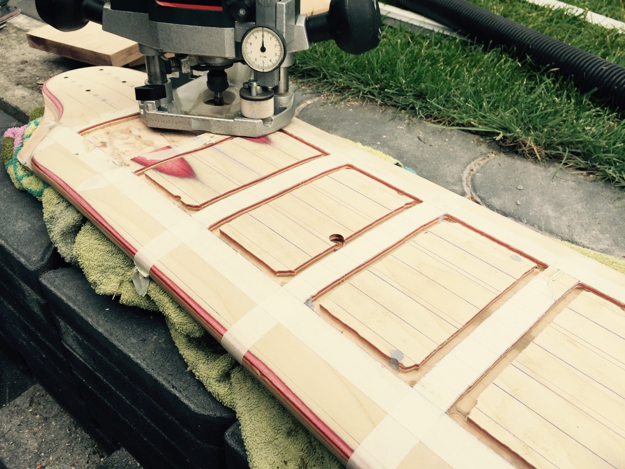

manual router, its not that easy to make really accurate straight lines with that thing. so yea, its often slighty bumpy - it hurts my sense for aesthetics, but I just cant help it. :?
routing done:

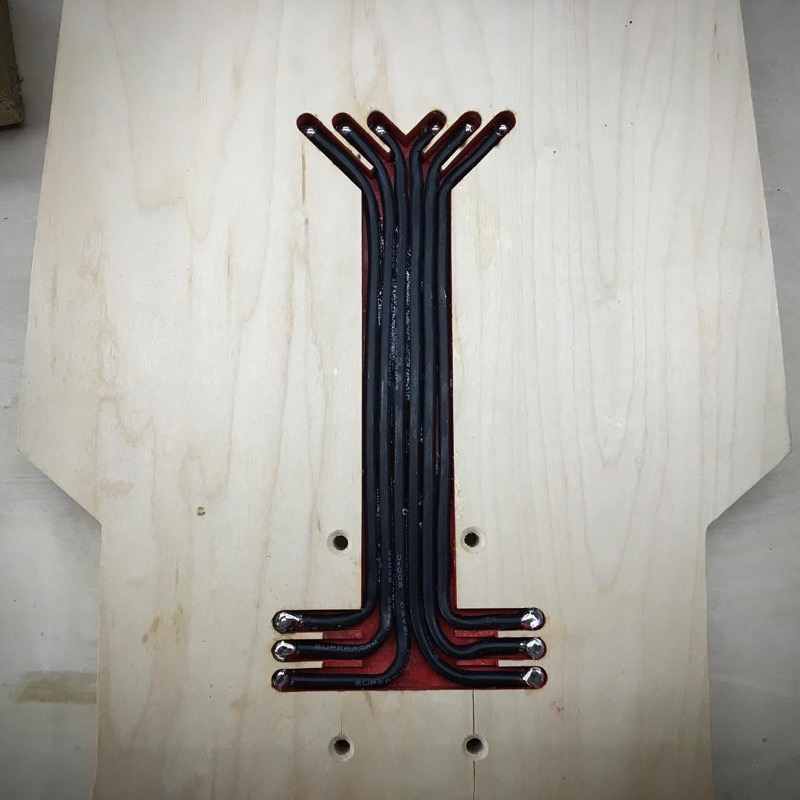

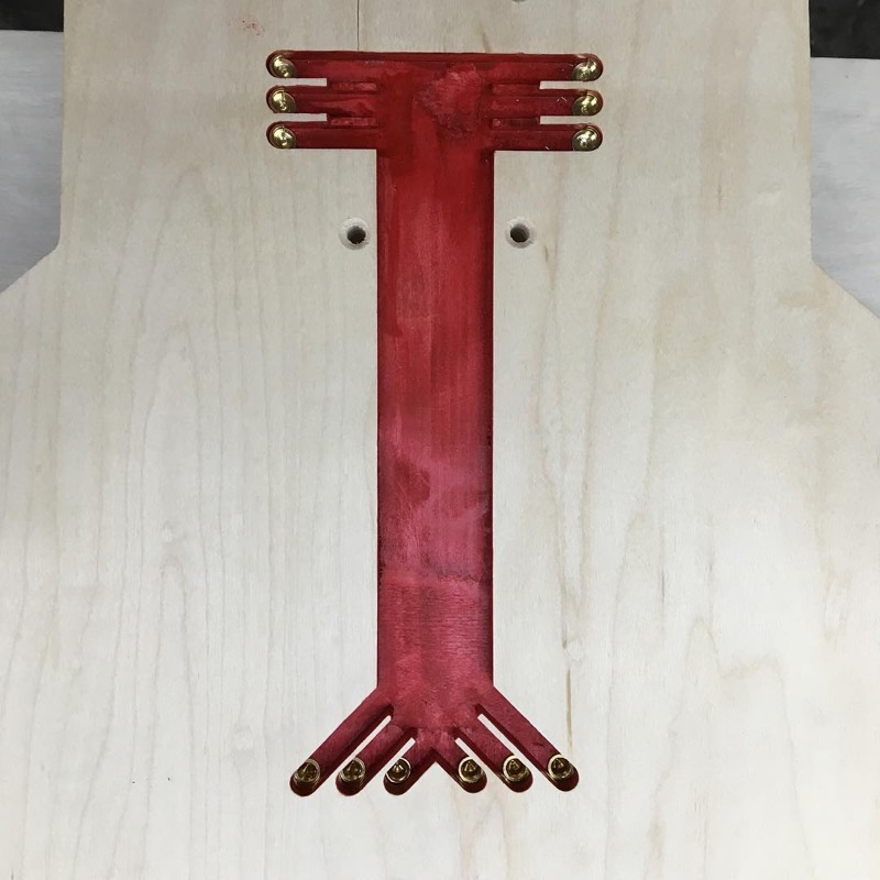

now Im still thinking about what to do with the cables. longhairedboy on the enertion forum just installed them permanently in the board ... Im thinking to do the same, since the channel in my tesseract wasnt particularly easy to set up compared to just permanently installing the cables. ill take a break and think about it .. :)
the more I think about it, the more likely Ill go down the longhairedboy route - that way I can start with carbon on the board now already and in the end just make 6 holes and route a channel ontop of the board below the grip tape. here is how longhairedboy has done it - gotta say I enjoyed the inspiration on the enertion forums - lots and lots to see there: http://www.electric-skateboard.builders/t/lhb-scarlet-black-metal-edition-12s-430-wh-18650-w-bms-ollin-vescs-enertion-dual-190kv-6355-83mm-flywheeel-clones/2475/89

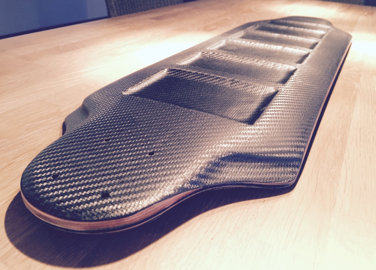

this vacuum setup was the best money I spent in a looong time :)
mounted the trucks for a quick flex check. the flex level is ... hmm, interesting? I would say its about the same flex as that of regular cruiser board, like loaded dervish sama/vanguard flex 1-2. I was a little afraid of standing in the middle with both feet and jumping up and down. felt like, if I really tried, I could bottom it out. :eek:

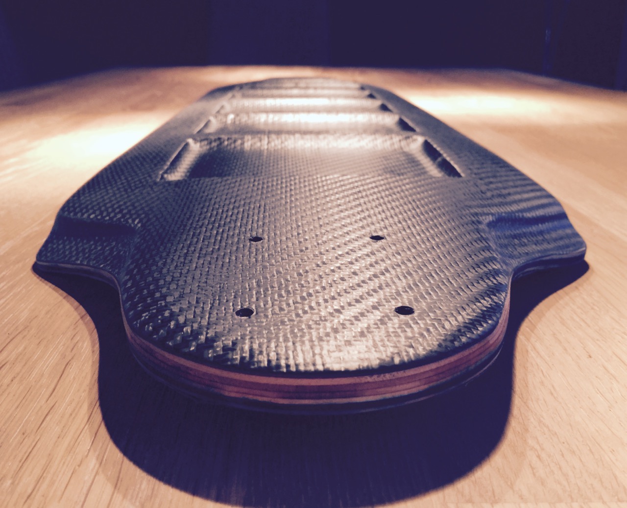

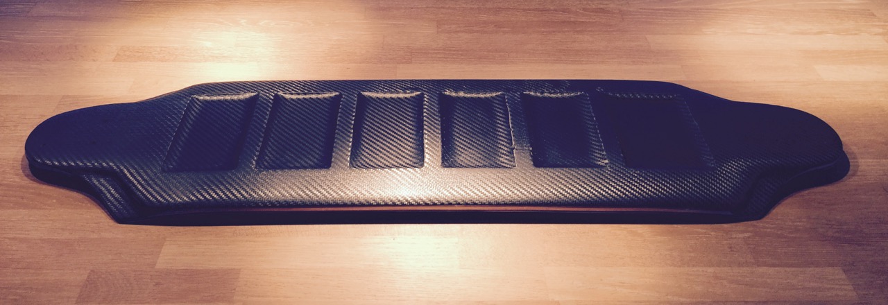

Im in a really great mood right now :D first of all I made a quick video showing the flex of the topspeed. dont really have anything but my phone to record stuff, so it sucks a little:
[youtube]5Usq1IDlvpk[/youtube]
felt actually a lot less flexy than on my first nightly try, think coming straight from my tesseract it felt quite soft, but now it just feels really cool. tried the board on the road (without motors), together with my new wheels that you can see in the video as well and duhhh, Im super stocked about both. the board is lively, springy and dampens everything so well ... and then these wheels ... :shock: :shock:
its the 3dm avila 75mm 73A duro (yes, 73A!!!). -> https://www.muirskate.com/longboard/wheels/3184/75mm-seismic-3dm-avila-clear-series-downhill-longboard-wheels
what a smooth and grippy wheel and its so small, actually felt a little softer than my abec 90mm 75A and definitely had a lot more grip - a revelation for carving on mediocre pavement!! wonder if I can use the custom drive gear of esk8.de with the 3 screws to attach it to these wheels? that would be really cool to have actually skateboard sized wheels with 90mm 75A comfort!! can finally drop my giant rubber risers as well with these kind of wheels!!
