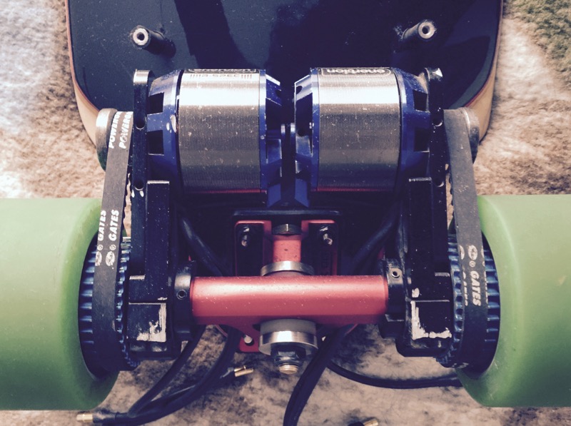

Torqueboard ESCs: they are holding up well, but I found 2 issues on them by now! first of all, the voltage cutoff with the battery is not always working as intended, for example if you switch off your board mid-tour and then switch it back on. Problem is that you define a per cell cutoff instead of a raw voltage cutoff - the thing tries to outsmart you and calculates how many cells you have in series. which is not working correctly if you switch the ESC on when the battery is at lower voltage.
the 2nd issue is: if I go into neutral at very high speed, then crank up the throttle again to resume my current speed, the motors often dont get into the right rythm right away and in the worst case they manage to brake REALLY hard for 1-2 seconds which at this speed is pretty horrible. basically I avoid going into neutral at high speed OR wait until Im down to relaxed speeds to resume throttle to get around that behavior.
finally: they are robust, but also really really large. Im building up a smaller lightweight board as we speak and I went with the vesc this time. not only is half the size of torques ESC, but it also has much better startup behavior, the superstealth FOC mode and lastly a working voltage cutoff that really allows you to leave out a BMS completely.

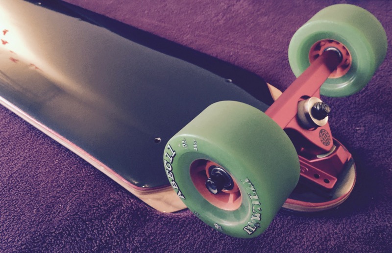

Flywheels 90mm 75A: by god, I learnt to love these wheels. secretly I think they are part of my low range, because they are just so soft and I feels confident enough to carve them up to a 4wheel drift at the end of a carving turn. supersmooth ride and quite a lot of grip even on rough pavement. really good choice ... pretty heavy though which is about the only downside I can think of.

TorqueBoards ESC - Don't rely on the ESC 100% to have the proper voltage cut off while at times it can be right. I don't just trust it 100% just like I don't trust a BMS 100% to fully cut off my charging when it's suppose too. You still have to remember to remove the charger from your battery pack even if it has a BMS.
As for the high speed issue and the brake issues. I haven't come across those issues. Please let me know if you find a fix for those issues or if you find out what's causing it. I am looking more into creating the VESC very soon.

the weird braking does not happen everytime and Im afraid to provoke it since it nearly threw me off everytime it happened, so im trying to work myself around it! :p
think with the ease of use, the controller performance, the noise and the form factor of the VESC, there isnt really any way around it anymore. Im glad I tried it for my new board. :)

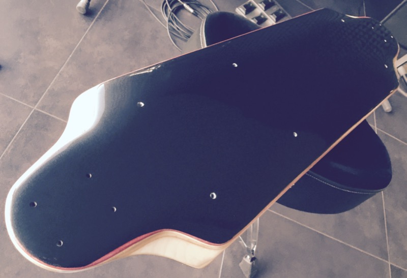

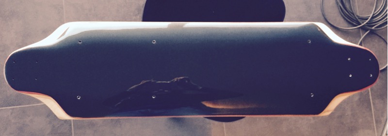

whitepony said:
sanded the board down from 8 to 7ply maple for some minimal flex increase. at the same time I also flattened the middle section by removing parts of the 7th maple ply - roadside you cannot see anything of the w-concave anymore, so hopefully the new enclosure will look even slimmer and more integrated than before. finally I spent quite some time trying to get a decent finish ... went with a glossy carbon grey metallic look and Im really happy how it turned out! will also fit the elegant carbon+aluminum enclosure perfectly! :)
Beautifull Paint job !
Can i ask how you painted the Underside ?, what kind of paint ?, did you use a Gun ?
wish I could say I did it all by myself, but I admittedly had professional help! :) primer -> volkswagen carbon grey metallic with a gun and a special hardener to be more resistant to chips & co. 8)
