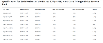

One thing that concerns me about the Leaf 1500w motor is that while it is able to run cool and efficient at 2000w (with the appropriate sized wheel) I don't think the average shark battery pack from EM3EV will be cool and efficient if used with such a combination.
For example, Samsung 35E cells are rated at 8 amps max continuous current. Since the largest shark pack from EM3EV holds 70 cells for 14S 5P that puts the pack's maximum continuous current of 40 amps (re: 5 x 8 amps = 40 amps) and yet going 40 mph with the typical bike from this thread will pull more than that thus pushing the BMS into its burst mode of 55 amps maximum.
Even the EM3EV Triangle battery pack at 14S 6P looks inadequate for the average bike build in this thread:
So if a person wants to push 40 mph with the chassis commonly found in this thread the battery should likewise be much bigger in order to match the efficiency of the motor. Pushing small batteries to max continuous power draw is hard on battery efficiency as well battery life.
Best to choose a bigger battery in order match discharge efficiency with motor efficiency. What is the point of having a motor with 90% efficiency at speed if the battery is simultaneously poorly efficient. In some cases (e.g. chassis limiting battery size) perhaps it is better to have a motor with less efficiency but with higher torque per amp when using certain small batteries.
