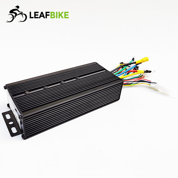

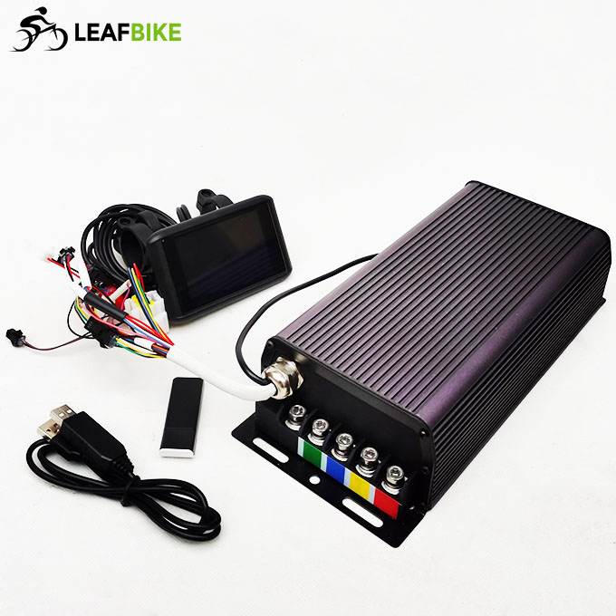

Previous reports have shown that the Leaf controllers are nothing great, does anyone know if that has changed?This 18FET controller from leaf
The majority of controllers currently on their site appear to be KT square wave (based on the serial numbers on the labels in the pics). KT places its labels on the top of the case. The linked controller, as well as one other 1000W model, have the label on the end of the case. If they are a common brand (not generic), then the DC Moto Controller brand frequently places the label in that location. Might be similar to the 18FET Ebikeling sells (dual mode, sine wave sensored, square wave sensorless).Previous reports have shown that the Leaf controllers are nothing great, does anyone know if that has changed?
